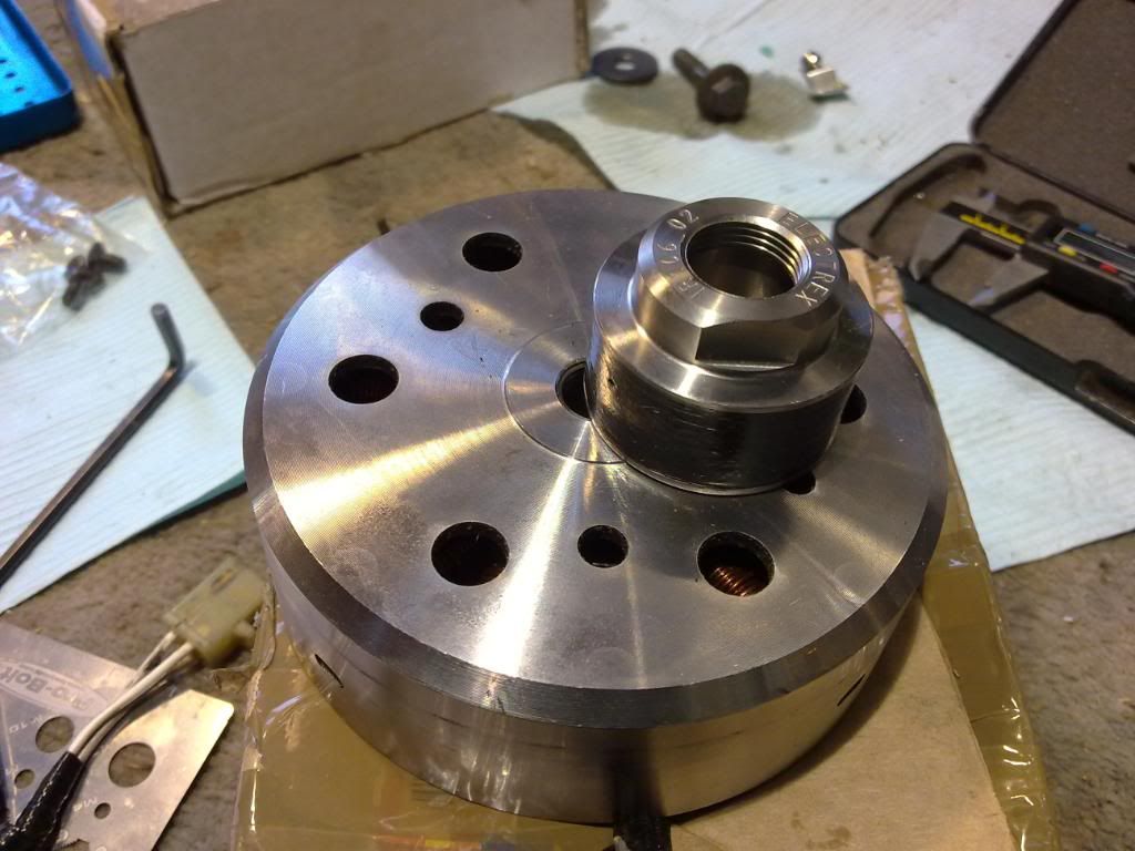

Thank you very much for this thread. I have been looking to buy a li-ion batery for my precious as the lead acid battery ,which is in the bike now, is on its way out. I found these batteries today would they work? I am not that clued up when it comes to electronics, posting and spelling.... It is alot like a normal AA battery just larger.

no , dont use li-ion , they might explode!
a123 are li-fe .li-ion cant be used on regular charging system .
if you trying to get a123 batteries , buy them from hobbyking :
http://hobbyking.com/hobbyking/store...l_Battery.html
those named "olevin power" , as a123 no longer exists , but they work the same .
i ordered 8 of those , and they work great so far , and very cheap!

before reading your reply I had tried the battery in the bike. It fortunatly did not have a high enough discharge rate to start the bike. I will try hobby king. Thank you very much sss r1
