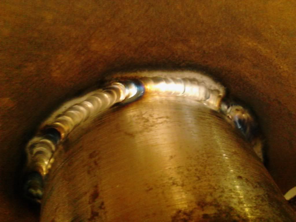

a lil hint of the weld magic and a personal project..
roll cage welding for the boss's 76 bronco
oyster crane, all 316 stainless. 1000lb capacity

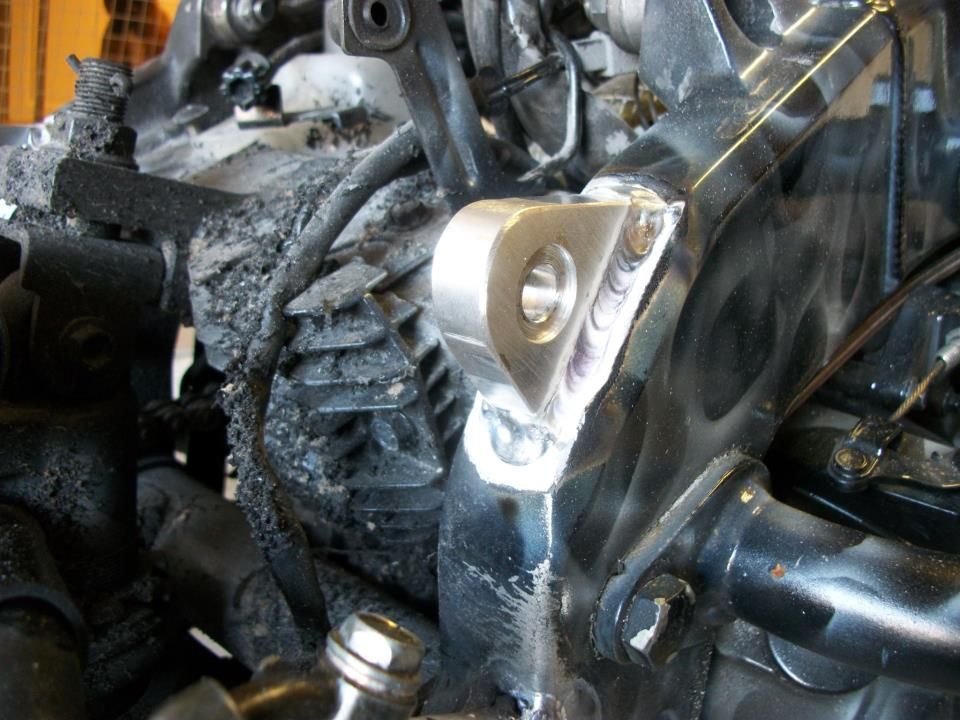

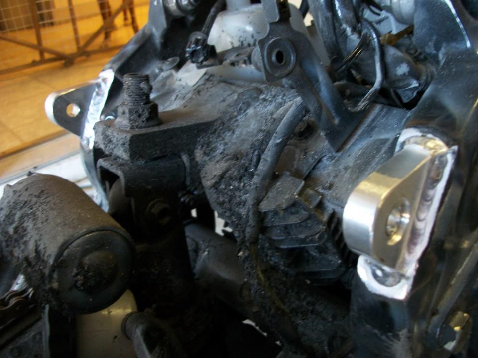

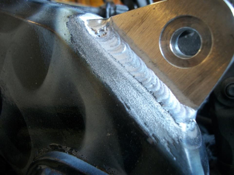

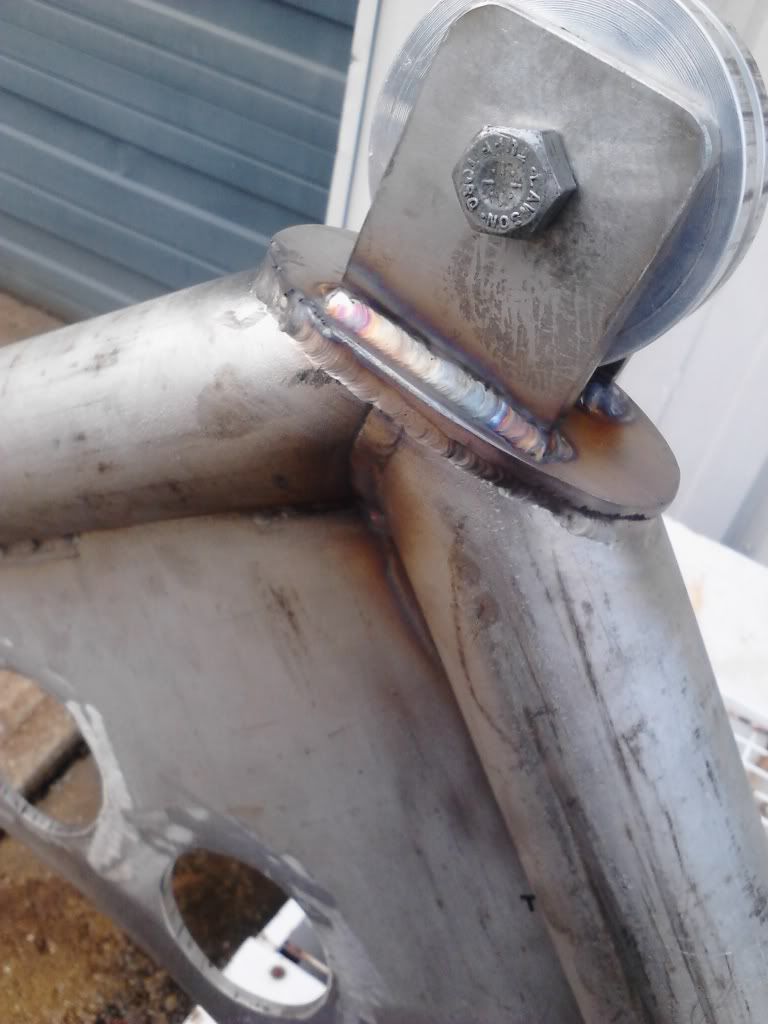

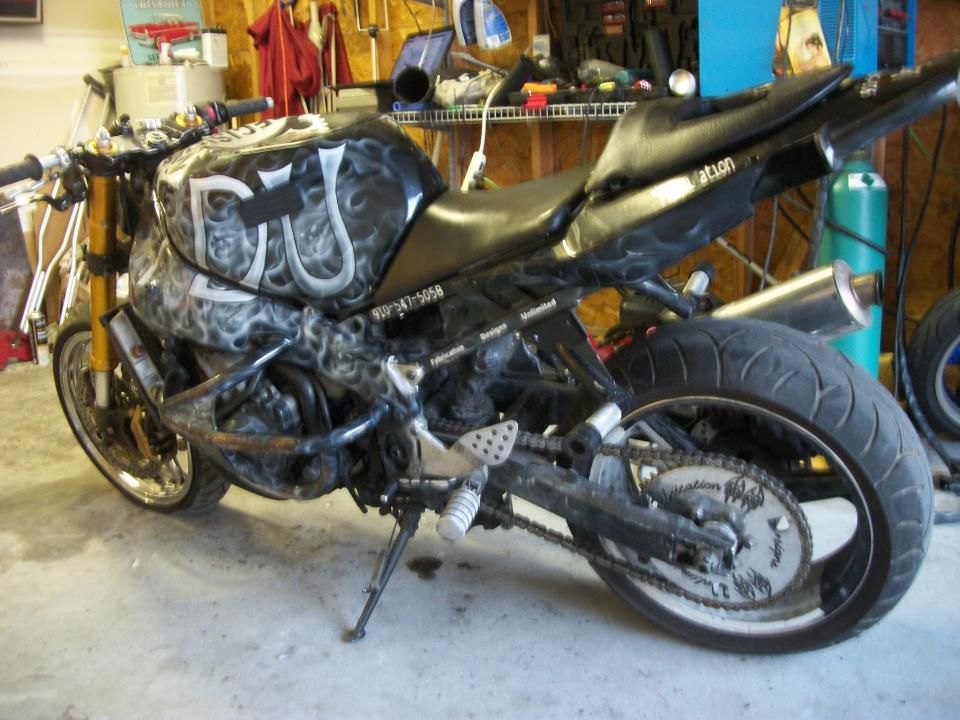

aaand here is a recent stunter repair.. did another baller status frame repair to a 636, but i don't know wtmf happened to the pics.
.500" 6061

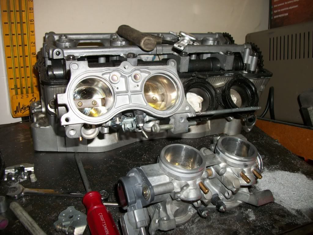

aaaaand a lil hint of some of my own shit brewing.. turbo/ EFI ZX7R.
parts list includes wossner gas-ported pistons, carillo H beams, magical head work, APE adj cam gears, megasquirt MS3x EFI, modified F4i TBs and.. well, a ton of other shit. ohh and the best part, a heavily ported/polished TB22 garrett, flowrate at redline come out to about 403 CFM at 90%VE, and on that turbo, lands dead-denter of the peak efficiency island at 13.6psi and a PR of about 2.0 ish. should be fun.. going for 250-300hp, and building for about 400ish.
heavily modded F4i TBs.. ported .180" and polished like a mufukka.
but ya.. thats my sort of resume for yas.. being i am some random tool who just shows up out of nowhere and bumps a thread and i am a complete and utter nobody here.. lol

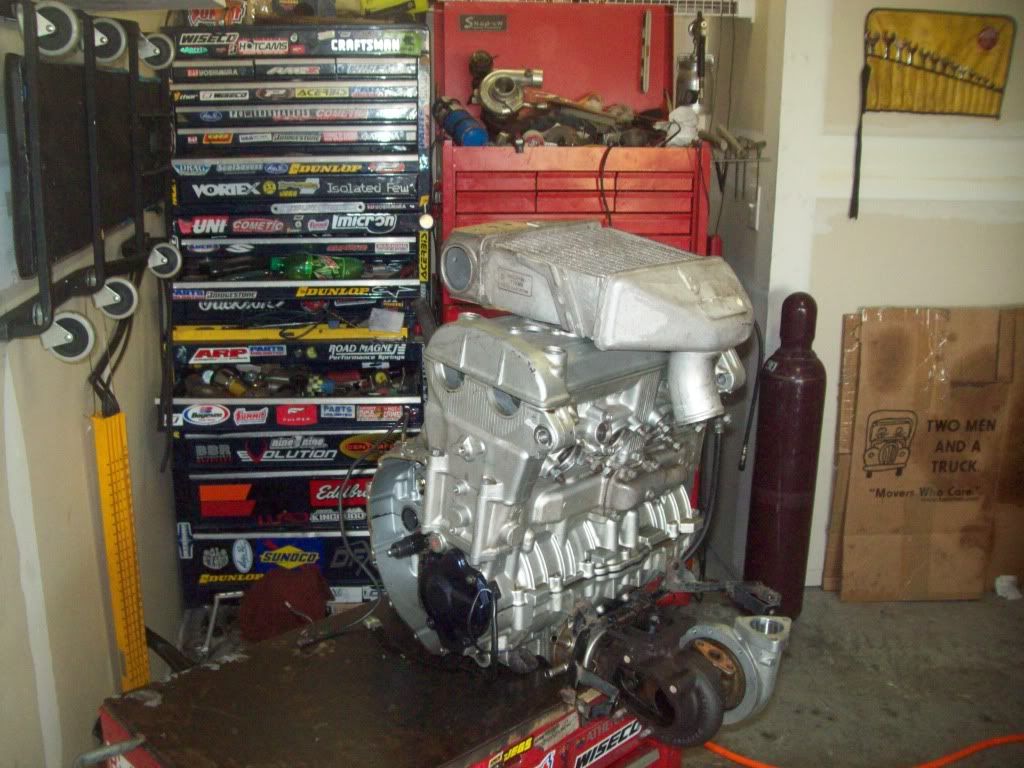

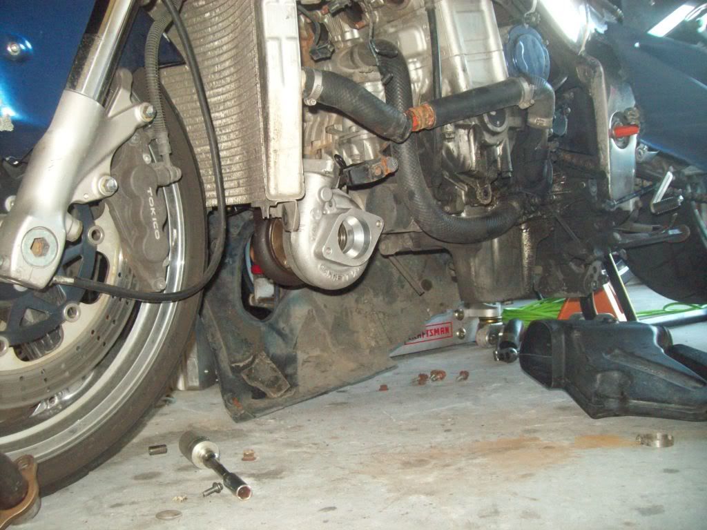

It's all good my man, the motor showed a pic of where you mentioned ZX-7R caught my eye. I've got a soft spot for those bikes as they were one of the first things I really fell in love with! What are the long term plans with that little beast?!?!
the green 99 has an APE knife-edged crank and polished cosworth pistons. right now has APE cam gears and a +4º rotor, but i am going to go to microsquirt on it and basically set the bike up for track use and some street use. i HAD a bitchin set of factory pro cam gears, but they got THROWN AWAY. DEF not due to my own stupidity. but it'll probably get some magic head work ( most likely epoxy to close ACSA to 60%).. also going to affix a nice steering stabilizer from an older 7 to it. it'll run the same modded F4i TBs in the pic above. those are widened between 2 and 3 about .490" and opened .180". i have yet to flowrate them or the injectors.
i have a dedicated 89 VTR250 racebike which is amazing. lol i will always track it more than anything, but the 7 will probably get toted to the track beside the VTR just to mix things up. VTR has probably 15K in it! kosman rims, 3 motors and just a bunch of shit.. very cool little bike.
as far as the blue turblow bike, it will be mostly land-speed. all i want is like, 210 out of it. "it takes 200 to GO 200" so if i am making a solid 250-300hp, i shoulddddd theoretically ( depending on wind, gearing, and track length) get about 220ish or so out of the bike.
mods as stated will also be EFI on a megasquirt MS3x ( x denote data logging) with fully sequential fuel and spark, secondary injectors in a custom airbox mated to a lay-down 2G DSM side mount intercooler, garrett TB22 (.48 compressor, .63 turbine A/R, but will eventually get swapped for a disco potato), carillo h-beams, wossner gas-ported pistons and low-tension rings, a BUNCH of my magic case modes, and most likely some trans work to keep it from dispatching clutch and gear parts at full boost. i plan on running staged boost per gear so i will start with a low pressure and each gear will step boost up, essentially acting as traction control. it'll see occasional street use as well.

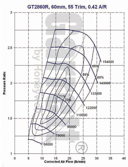

OK!! lets get to some business regarding the bike! lol (tryin not to derail!)
we talked about MMmmmmmbooooooost today!! my fav subject.
MANY many many people talk a LOT of shit about turbos and think they can get away with slapping a snail on stuff and just make majikal horepowurz, but there IS engineering behind it! i shall show you a bit of the magic.
now, this is NOT confirmed.. the motor may stay NA, but for now, we'll crunch some numbers and size a turbo for the application. i suspected from day 1 the crossplane motor would love the hell out of boost since the firing order permits smooth exhaust pulse flow.
alright.,. the first step is finding flowrate.
flowrate in CFM.. as we will use that same number to find the correct compressor size.
CFM= (cid x max rpm x .5 x VE) / 1728
( there is a variant of this using VE AND density ratio, but for simplicity, i will leave it out)
cid is displacement, max rpm is just that (redline), .5 is just a constant. use 1.0 for 2 stroke, .5 for 4 stroke, VE is volumetric efficiency ( in percentage) and 1728 is the amount of cubic inches in a cubic foot.
ok.. being theres 0.0610 CC in a Cu, just multiply.. rounding up to 1000, we get 61.023 CI.
for VE, we will use 90% which is just a relatively decent number. back in the day, 80-85% was the magic number for a standard motor, and mid 90s is race-spec, but with the advancements in port harmonics and tuning with pressure waves, it IS entirely possible to see VEs of 125%. you figure, F1 motors spin to 20,000 rpm. the cams spin at 50% so the valves open 10,000 times a minute.. air hates that shit so the valves pretty much float and never close, and port harmonics takes over.
anyway yeah.. 90% expressed as .9
max rpm is 13750.. so, its that simple. plug dem numbaz in yo!
so (61 x 13750 x .5 x.9) / 1728 = 218.42 CFM
now, depending on the application we can move around this number to compensate for mods , but again, for simplicity, we'll just keep shit simple.
now that we have that, we figure what a reasonable HP goal is, and what mods will be made to comp for that power. in this case, the motor would remain stock and boost low, so we will use 8-10 psi as a range.. we'll just stick with 8 assuming a 10-11psi spike on boost at top spool speeds.
with that boost, we figure whats called pressure ratio. that is used for figuring the compressor flowrate and where you're at on it's map. theres a post called the peak efficiency island that you really want to stick in on or around. its bad drifting to the left to whats called a surge line. ported compressor shrouds get rid of some comp surge, but in general, stay the hell away from the surge line. it overspeeds the wheels as well which kills bearings.
ok PR = (14.7 + boost) / 14.7
(14.7 + 8) / 14.7 = 1.59... i will call it 1.6
so with a flowrate of 218 cfm and a pr of 1.6 @ 8psi, NOW we can apply it to a compressor map. you kinda need a general feel of what turbo will work so you can nail it quickly, but it's not necessary to know what frame series you should start off with. you'll find it eventually.
overall rated crank HP is about 180hp.. with 8 psi we can expect a reasonable 15-20 hp with a good tune. 15psi "doubles your displacement" on paper, so i honestly just derive a basic number and water it down a touch to get a general number.
as a note, some times comp maps are noted out in pounds per minute instead of CFM.. 1lb/min = 14.472 cfm.. so in this case, divide 218 by 14.47 and we get 15.06 lb/min
now, being i am tired and kinda wanna stop typing since i have a massive headache, i skipped to a turbo i know will work, but YOU can still apply the general rules of sizing since i've outlined them. turbo by garrett has some nifty shit on their site to help cut some of the riff raff and time out of selecting the correct snail, but to go to my talking about MY project bike making 250-300hp, and wanting to run a "disco potato" (GT2860RS) that tells ya that THAT turbo's general flowrate meets or exceeds the flowrate of the motor at that power output. within reason, you can go up or down a bit in flowrates, but you REALLY need to stick closely to trying to the right numbers.
anyway, so right off the bat, i am guessing a GT2860 is about the right size. garrett says its rated for 150-310hp and motors from 1.8-3L. now, being the R1 spins as fast as it does, we can assume then that the flowrate of a smaller motor at a higher rpm is equivalent to a bigger motor spinning slower. HP is the same either way, and all the other numbers ( flowrate, BSFC and such) is relatively close.
ok.. having the garrett site pulled up, with your numbers, go to a general turbo and pull up the "performance map" which is the comp and turbine flowtrate mapping we're crunching numbers for in the first place.
now, looking at this map ryyy churrr we can start to see wtf those numbers do.
the numbers to the far right are wheel speeds. thats the reason turbos whistle.. the tips of the blades are breaking the sound barrier when you're spooling that bitch up. the horizontal lines at those wheel speeds sectionalize the speeds per flowrate and PR.. you can see how they ALL rise approaching that deadly surge line to the far left.
the small percentages are the efficiencies for that flow quandrant. whatever circle that number resides in, that WHOLE ass circle is that efficiency.
the trim denotes a ratio between the smaller section of the turbine or compressor wheel to the bigger section. the smaller section is the inducer ( on the comp wheel) where the air enters. the air comes out of the larger exducer section.
trim= (inducer/exducer)² x 100
now using the 15.06 from earlier and the 1.6 PR all we do is plot the graph.
well, looknig at the map and charting out the PR in respect to the flowrate, we land just east of the PEI, but we're still VERY close to it.. honestly, close enough for a street application at low boost. so this guess was relatively good! ( well, educated, but when you do this a few times you get a feel for what works and what doesn't)
sure we can tweak and perfect and get DEAD center on the PEI by juggling numbers that can still work, or by juggling housing styles. if the A/R of the compressor is too small, the flowrate of your application will grossly exceed the max airflow of the turbo and you risk damaging it. conversely if you're too far away in flowrates and the turbo is HUGE, two things happen, A, you put yourself outside the PEI so far that the compressor can't even really make any good airflow, and B the turbine is usually appropriately sized and will be toooooo big for the exhaust flowrate. moving UP in the A/R on a turbine makes it spool later, so a land speed bike would be a good application as you'll be at WOT for long periods of time.. at bonneville, sometimes 70 seconds at a clip. a smaller AR spools fast and is good for street and drag applications. twin turbos can net better lag times with staggered numbers, but THAT in itself is a big damn post on the variants of twin arrays. moving up on the compressor AR grants more air. smaller is less air, but you can choke off the motor for air and risk comp surge and overspeed and lean the motor out as well killing more shit. smaller ARs will be good for low-revving applications where you're not in the top end of the revs.. something like some road racing on tight ass tracks would be apropos.
A/R is a ratio of the center of the outlet to the center of the housing, called the scroll. if you peeled open a turbo, the whole thing looks like an ice cream cone. the small point is the beginning of the scroll and the big end is the outlet (or inlet on the hot side) and the A/R tells you the general size of the actual scroll size.
uhh.. i am kinda losing my train here with a headache and fatigue, but you get the general scoop. you CAN'T just toss a snail on a motor and make it work. you can hope.. thats about it.

WOW! That's pretty much the best explanation of turbo applications I've ever had someone take the time to explain.
