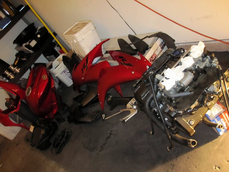

10-19-2009
--Disconnected all items from the harness, removed kickstand, drained oil and coolant, supported the engine with a hydraulic jack, removed engine mount bolts and bolt sleeves, lowered the engine out and wheeled it out of the way
--Removed AIS system from 07 engine and replaced the spark plugs with NGK Iridium plugs
*Findings; discovered that I must use an 07-08 fuel pump assembly due to the non-return line fuel rail on the 07 engine. Looks as though I will need to swap some of the coolant lines from the 04 engine over since I am still using an 04 radiator.
Pictures:
07 Engine w/ new plugs and AIS removed
04 engine w/ full harness
Super light-weight R1
Exhaust, 07 harness/ecu/intake box (and other junk from my garage)
My, now occupied, garage
