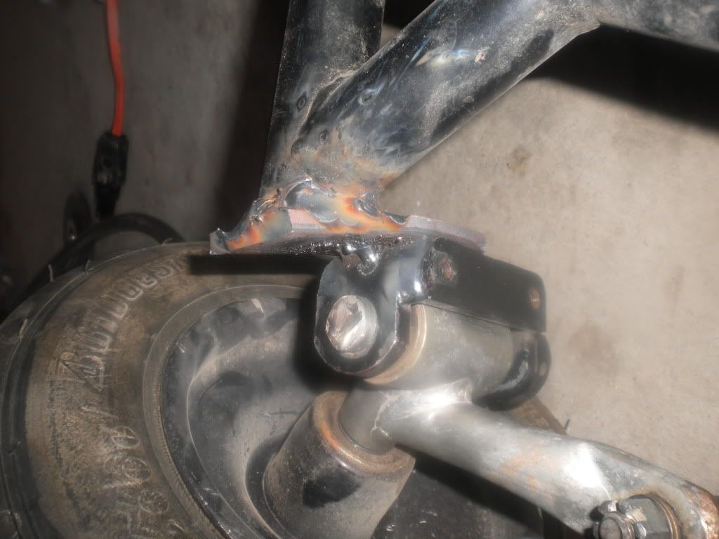

so first we had to start off giving the kart a little lift in order to make everything fit and not hit a 1 inch rock and bottom out.
started by extending the rear end and where the axle mounts i flipped it to raise the rear about 3 inches maybe 2 and 1/2 but that made it sit super aggressive and snowplow the front side so chopping the front hubs added a plate and sent those down 1 and 1/2 to 2 inches...an inch lower then the rear.
just realized i didnt take a picture after we built the brace in to support the new shape of the front hubs...o well =/
put the r1 sprocket on the rear axle. it adjusts from left to right but the issue ima run into is i need to make a chain tensionor and also a chain guide out of hard steel as it sits pretty f***in low to the ground.
Setting the motor in and making me some mounts was another task today. i dont have mounted pics yet but here is the set up and prep work tieing it in making sure it didnt swing as we welded the mounts were we wanted them.
MORE PICS TO COME as soon as i get some time to get in the garage lol
