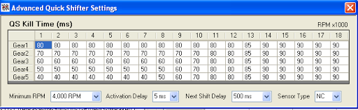

Q: What quick shift settings should I use?
A: Currently the best 09+ settings are found in the 3/4 system dyno tune. Flash-Tune tweaked these parameters on the dyno to produce nice smooth shifts. If you are not using the 3/4 F-T map, you can copy the values out of that map, load your map, then paste them into your map.
These are the settings for the 09+ QS. This also gives you an idea about what seetings you can change.
( I need input from 07-08 QS users for good suggestions here. )
