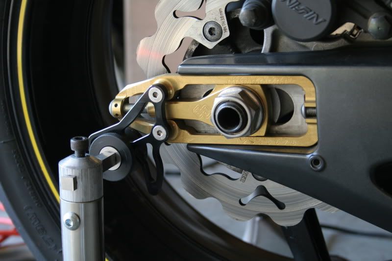

Secondly, I bought a pair of Gilles adjusters and lifters(I think that is what they are called?), and after changing my sprockets, and installing them, there is a clicking noise... Now I've pinpointed it down to the lifters clipping my bolts/nuts. Is this a sign that I installed incorrectly? Or perhaps that I just need to take the bolts off the lifters and file them down?

Nothing on the adjusters/lifters should hit anything. Post a pic and I can probably tell you what's wrong.

Here's a photo of what's rubbing Redgecko. Click image for larger version

are you sprocket nuts hitting?

Your lifters should mount on the outside - not the inside of the adjusters. That'll take care of the extra bolt length being where it shouldn't and hitting the sprocket nuts

Yes. And to my knowledge, the wheel is straight.

Where did you get those adjusters from, they do not look like 04 R1 adjusters to me.
Do you know what model they are or can you get a side pic.
One thing is sure though, as said the lifters should be on the outside.

http://www.oppracing.com/product_dis...ain-adjusters/
These are the ones I have.

Originally Posted by NicholasRomano View Post
I thought they were different between the years?. That site pretty much says its universal.
I think this could be the problem as I have not seen the TCA adjusters listed for R1's prior to 07 before, they have always been the KTS style I posted.
If you look at the swingarm on an 07 onwards, the thickness of material that the adjuster sits on, is about double that of earlier models. If you had this extra material on the 04 then I do not believe the bolts would be hitting and hence the problem.

Would you suggest scrapping them entirely then? Or just shaving the bolts down a little. They look pretty awesome and find them to be fairly helpful. With the exception of the slight rub, they appear to fit well.

Just change or shave the bolts if you think the fit is good.
One other thing looking at the pic you posted, why are your rear spools so long, I'd be nervous about that much leverage on a 6mm bolt, can't you lift a little closer to the arm.?

Moved it closer to the arm, and switched around the lifters. No more rubbing! Thanks for your tips and help guys.
