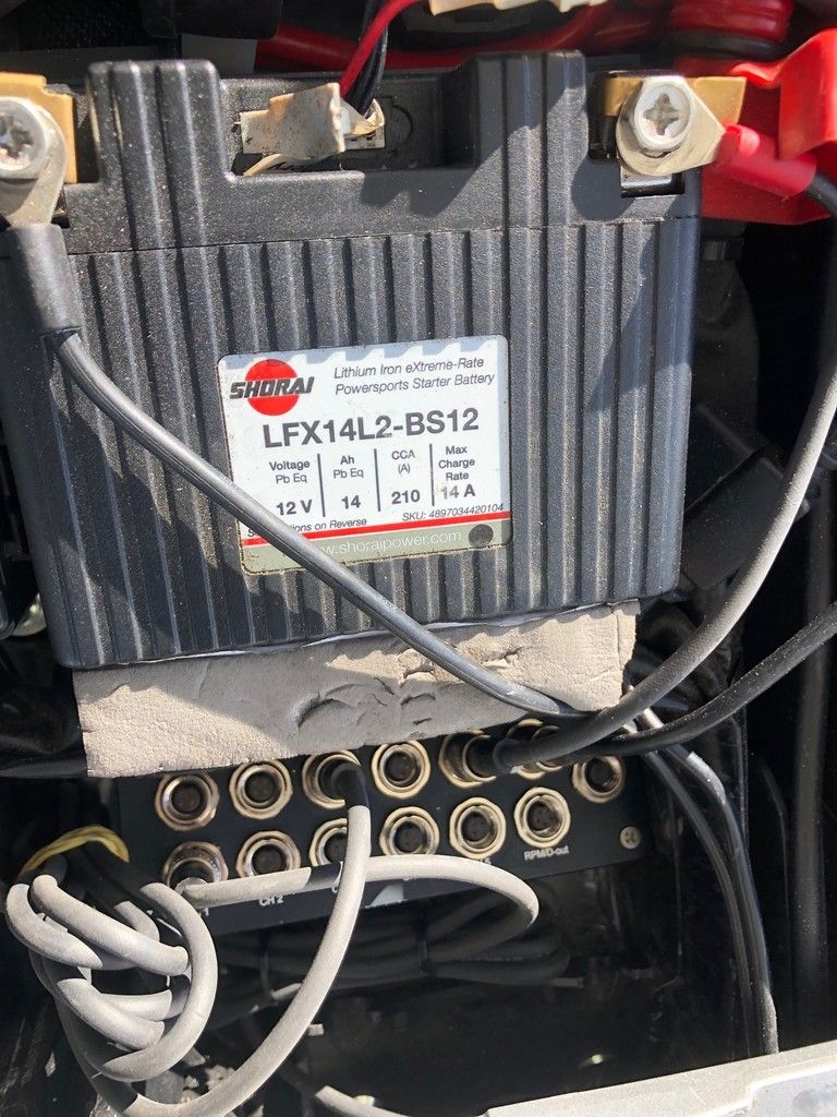

Here's a pro tip O learned over the weekend. If you're running a datalogger like mine, the AIM Evo4S, make sure you disconnect it from the bike in between uses. It drains the battery even when not in use. Cost me a whole days worth of practice this weekend at the races in Las Vegas

Yes power to plug that goes to AIM comes directly from battery. You need to change it to switched power so AIM would shutdown with bike. Also are you using CAN_2015 in AIM config? There is also ftecu can protocol available that has 73 datalogger channels comparing 33 that comes from Yamaha CAN_2015.
I don't know what any of that means lol.

Maybe picture will help. Picture on left using AIM "stock" preset for R1 (33channels available to log with EVO4S). Picture on right using ftecu custom CAN protocol file (73channels available to log with EVO4S). Stock preset channels don't actually tell too much about bikes electronics (TCS/LIFT/SCS etc.)
About power. Use from switched power source not directly from battery. It will start and stop with bike.
Ok I'll look into switching the ECU modes when I get home. Thanks bro

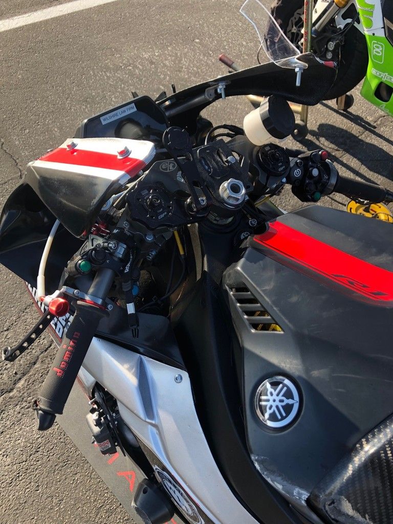

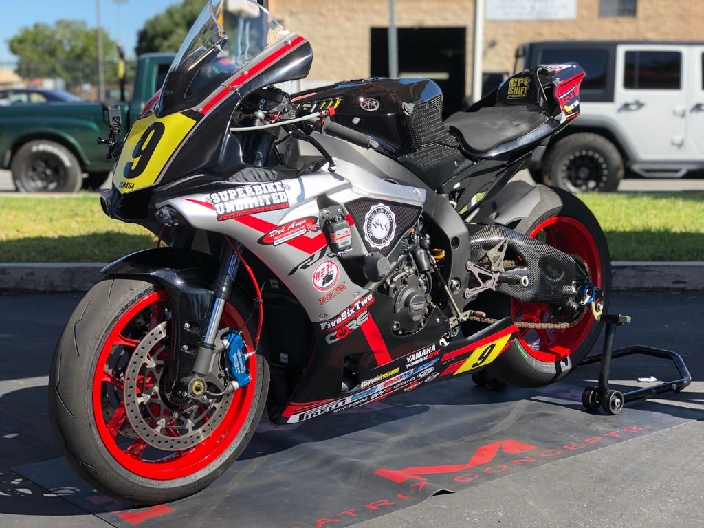

Updates!!
Well obviously my race didn't go as planned. Dead battery prevented me from practicing in the morning, which meant I had to practice during the race. Ended up crashing out on lap 4. Damage to the bike wasn't that. Broken MRA windscreen, light fiberglass damage, and a broken front fender. Was able to get the bike repaired in time for my sponsor obligated appearance at Del Amo Motorsports in Redondo Beach. Had a great time talking bike stuff with people and getting a few signed up for a trackday Del Amo is hosting at Chuckwalla. I had them bring me a stock R1 to help show the potential from stock to full race bike. The guys got so much positive feedback from the customers that I was able to walk out with a brand new AGV Corsa helmet!
Not quite race ready, but definitely looking the part!
Tried testing out the AIM Datalogger but for some reason it didn't record anything. Still working on that
As you can see, only minor damage to the bike after the high side crash
I was practicing learning to fly. Didn't stick the landing though lol

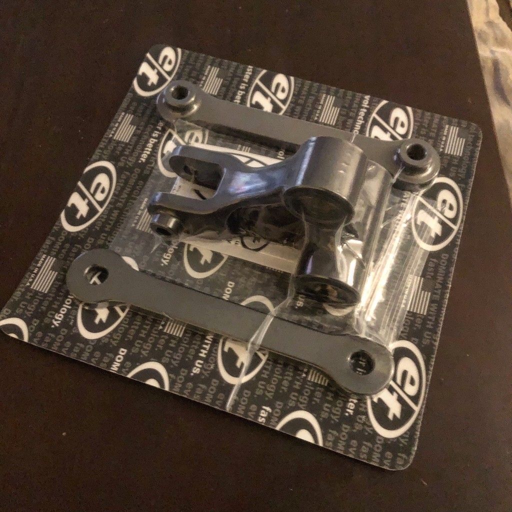

Next up I'll be installing the new EvolTechnology rear suspension linkage (the Pirelli version). Should be easy enough

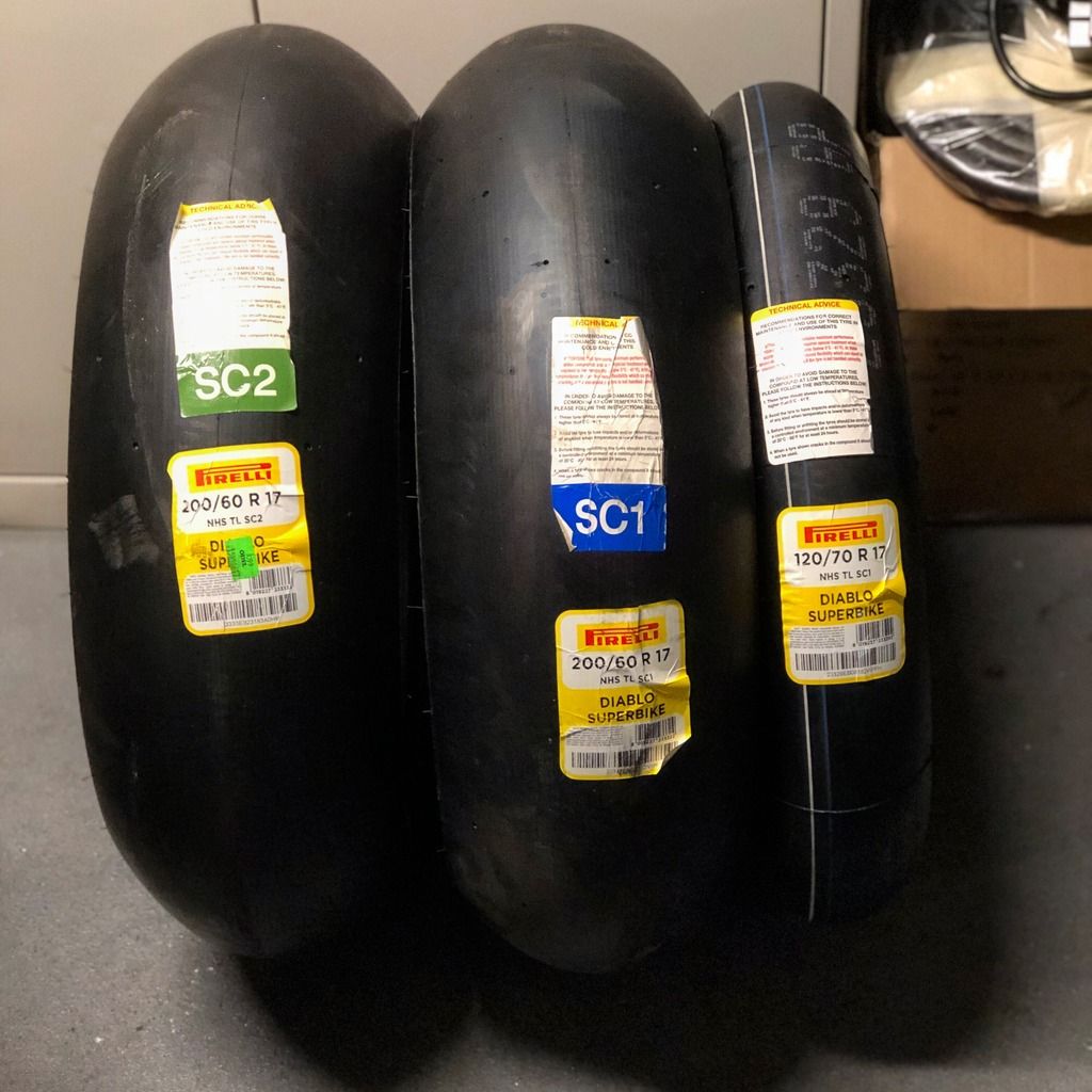

I'm also ready for the next couple of races with my new slicks having arrived today. Looking forward to some Las Vegas redemption!
I tried to run the power cable to the ignition switch and it burned the ECU connector cable. Not sure how. Can you provide any insight on what i should use to power the unit? Also, I couldn't find the FlashTune CAN protocol in the ECU area. Am I looking in the wrong place?
There are many power sources that are switched but I would use same that powers CCU. Fuse name is backup. Optimal would be buying plug and wiring it so that you only take 12+ and GND from connector that goes to CCU.
You need to download CAN protocol file from ftecu site and then import it to Race Studio 3 (Preferences/Advanced/Import Can Protocol). First google result points here.
