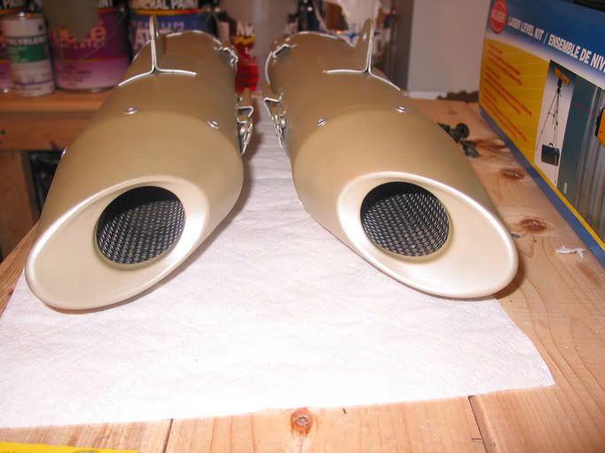

A tip not in the instructions for anyone doing the baffles. Put the seam at the top.
I am getting ready to do this in the next couple of days. I assume you are speaking of the seam in the baffle and it's orientation to the top of the can. :dunno How does this tip help :dunno
Letzroll
Joined
1,122 Posts
In looks I guess ? I plan to install the baffles soon myself and it will probably look better not seeing the seams...or if you do see them it will look more aligned being at the top.
Got gold?
Joined
224 Posts
Yes, its for looks, the seam will show if on the bottom. You may not care but you would have to rip open the cans and swap the baffles side to side to correct. Test fit when you get them, they work one of two ways, seam up or seam down. Might as well do seam up. This is not mentioned in the instructions. Here are mine with seam up, not visible.:)

Got it :yesnod thanks for the advice ... something like that would have driven me nuts after the fact :rant
