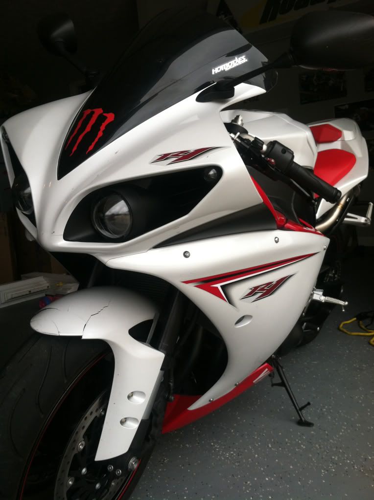

Before the conversion: (Bike was backed into at Mellow Mushroom)
After Conversion:
See less See more
I think it looks better but the newer upper is thinner than the first version.
Looks great Stober, glad you got it back 100% after that dirtbag backed into you. Weren't you going to meet your wife/daughter when that happened?
Thanks brother. Yea I had been out for an afternoon ride and then I met my wife and kid at mellow mushroom for lunch. We were sitting on the front patio, I never heard it get knocked over and by the time we finished eating and walked around the building it had been laying on its side for at least 15-20 minutes.
Sickening feeling for sure. I'm almost lost my lunch when I realized someone had backed into it. At first, I thought I had done something wrong when parking, but the 6-8 inch kickstand gouge in the asphalt and the shattered front fender made it certain that someone had backed into it and drove off. Bastards!
