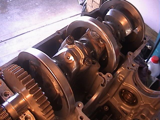

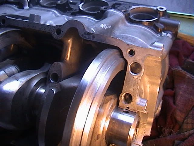

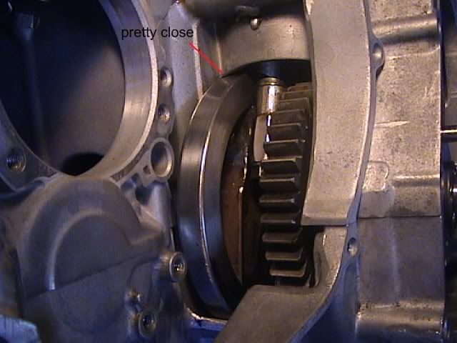

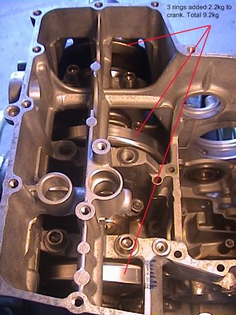

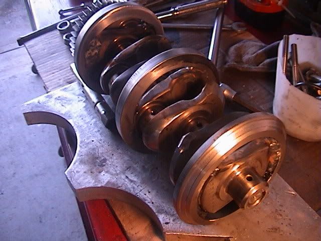

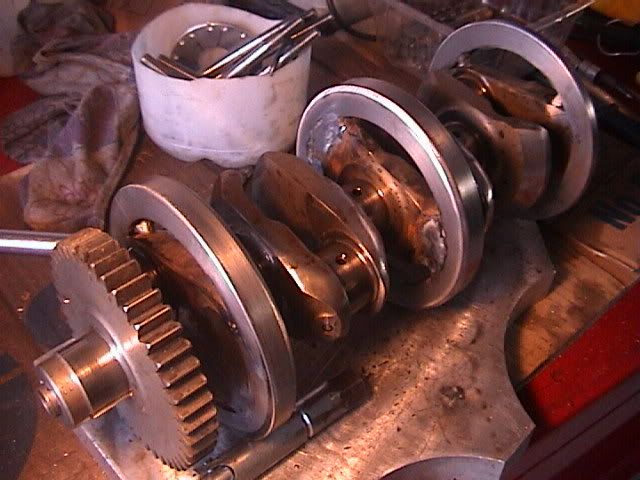

Added 2.2kg to the crank right out wide. This is an extreme amount but need to know what effect adding too much weight might have. Hopefully increase cornering speed by smoothing out the power. This is my 98R1 but i will be doing this same mod to my CBR (if it works)
