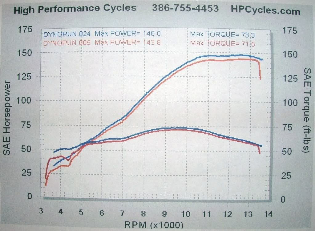

Here's the end results:
Power mods include:
  • Hindle slip-ons
  • Arrow 4-2-1 header
  • Factory Pro velocity stacks
  • K&N air filter
  • Gutted stock y-pipe
  • PCIII USB
I took a video of one of the runs, but I'm still waiting to get it off my friend's camera.
Comments please!
