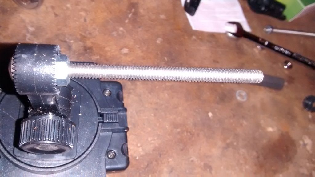

-1/4" stainless steel pan head stove bolt (3-4" long)

Step 1:
Assemble mount shown here

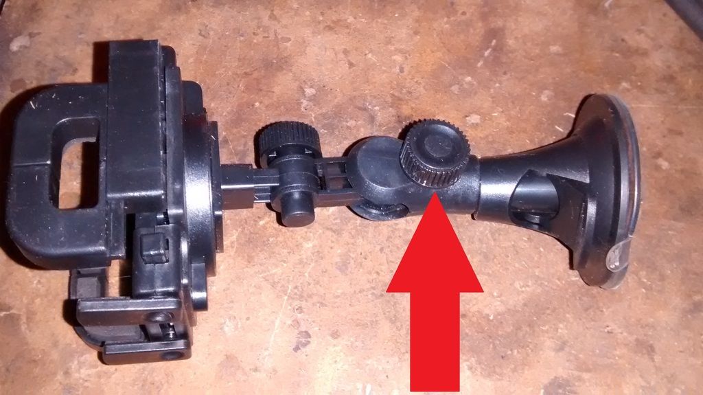

Step 2:

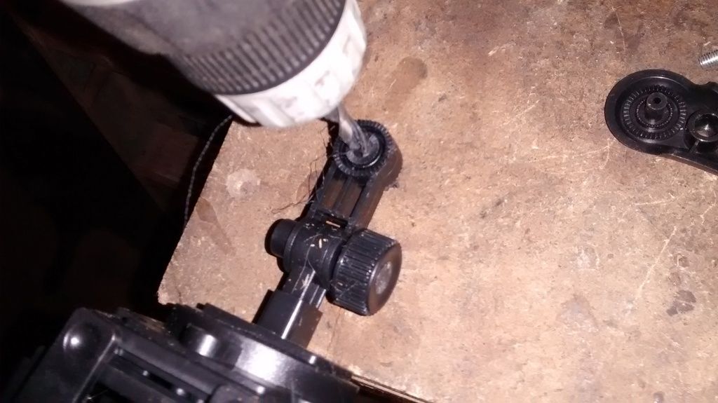

Remove lower adjustment bolt shown here
Step 3:
Drill out hole with a 1/4" bit
Step 4:

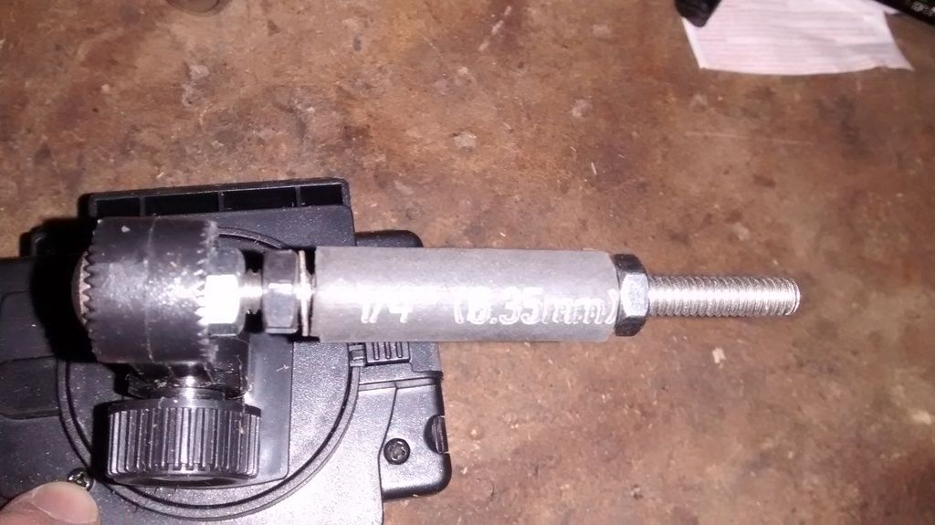

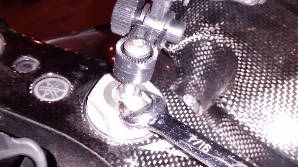

Install mount to stainless bolt with a nut and 2 washers (don't over tighten or you will crack the plastic)
Step 5: In this order install a nut, washer, rubber hose and another nut

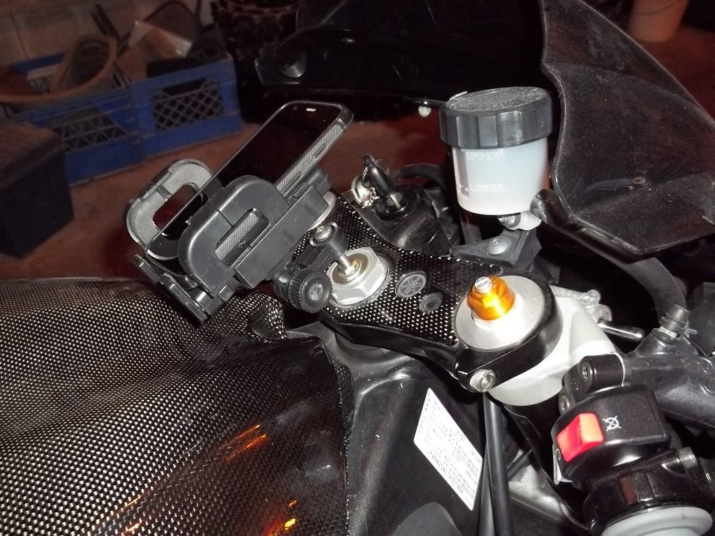

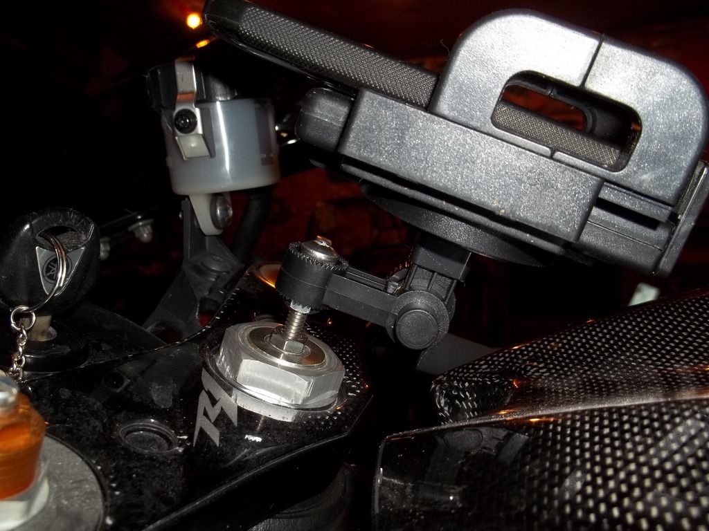

Step 6: Install mount into the bike stem hole, and while holding the mount tighten the top nut leaving it flush with the top of the hole. The rubber hose is pressed out to hold mount in place.

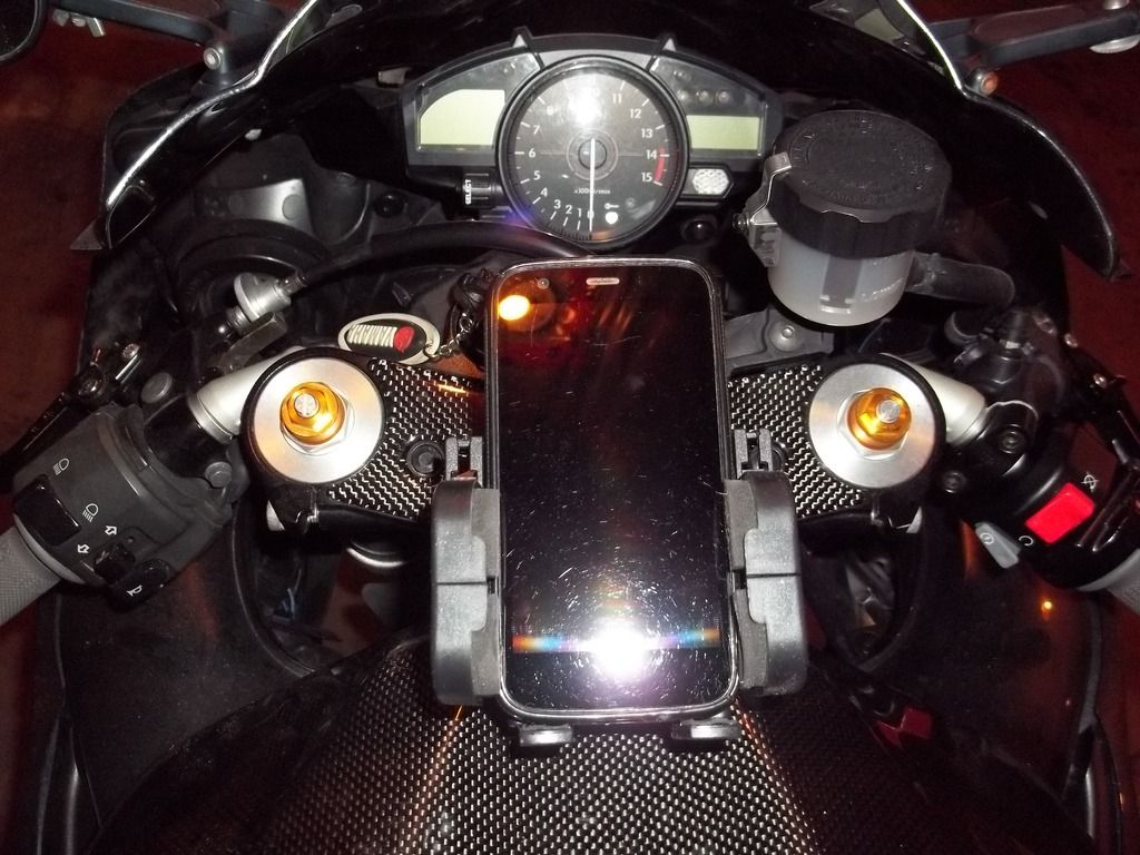

Finished Product:
(this mount also allows you to swivel 90 degrees either way and lock into place if needed)
