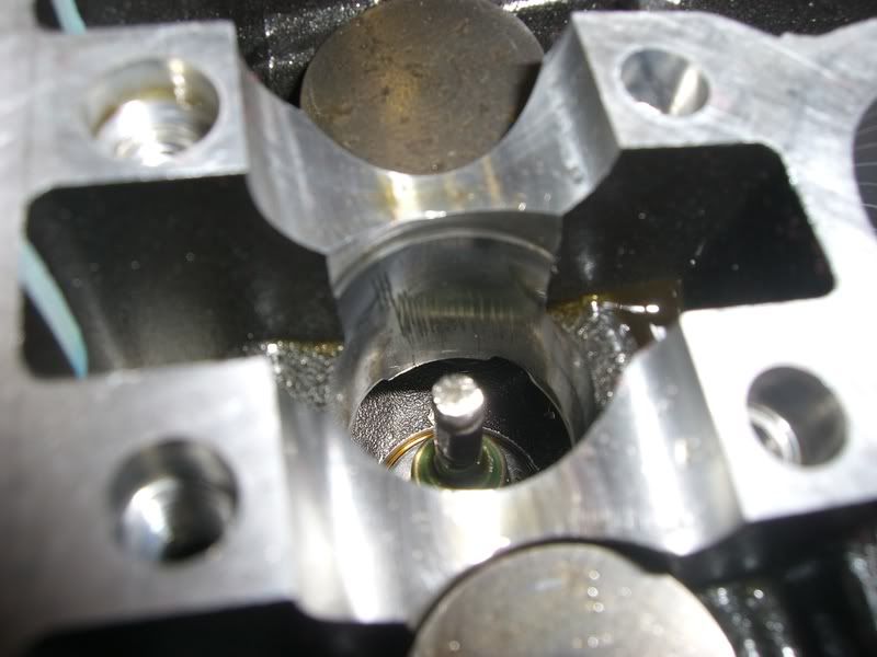

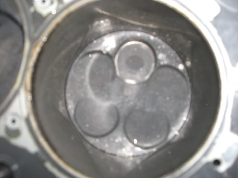

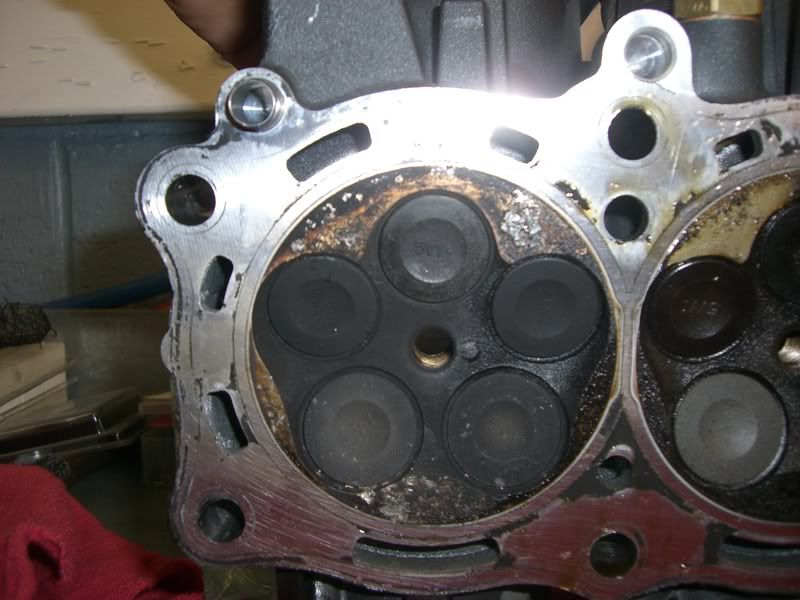

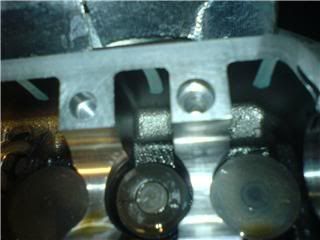

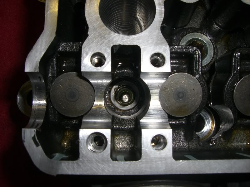

so my head was taken off today and found out that i dropped a valve. luckily, all that happened is that my piston just slapped that valve a bunch of times and didn't actually fall into the cylinder. so, i'm putting in some new JE pistons, thinner head gasket, degree the cams, and i'm upgrading to a full exhaust. afterwards i'll get it dyno tuned. so this should add a few extra ponies.:jump here a some pics
this is a pic of the spring retainer cracked in half
the head
the valve
piston
head

make sure and hone out and clean up head where bucket goes. looks like it got little scarred up. nothing that cant be fixed.
really no point in milling head and running thinner gasket.. unless ur trying to get to certain squish number. but clearances just wont allow much. stock headgasket is .020 thick. split it and its .010. YEC gasket thats not findable now is like $150 and it measures .012 i think. plus new stock gasket is cheap..but i always reuse old one anyways when i split it. it is worth little gain and worth doing. glad u caught it man. it could have turned ugly.
