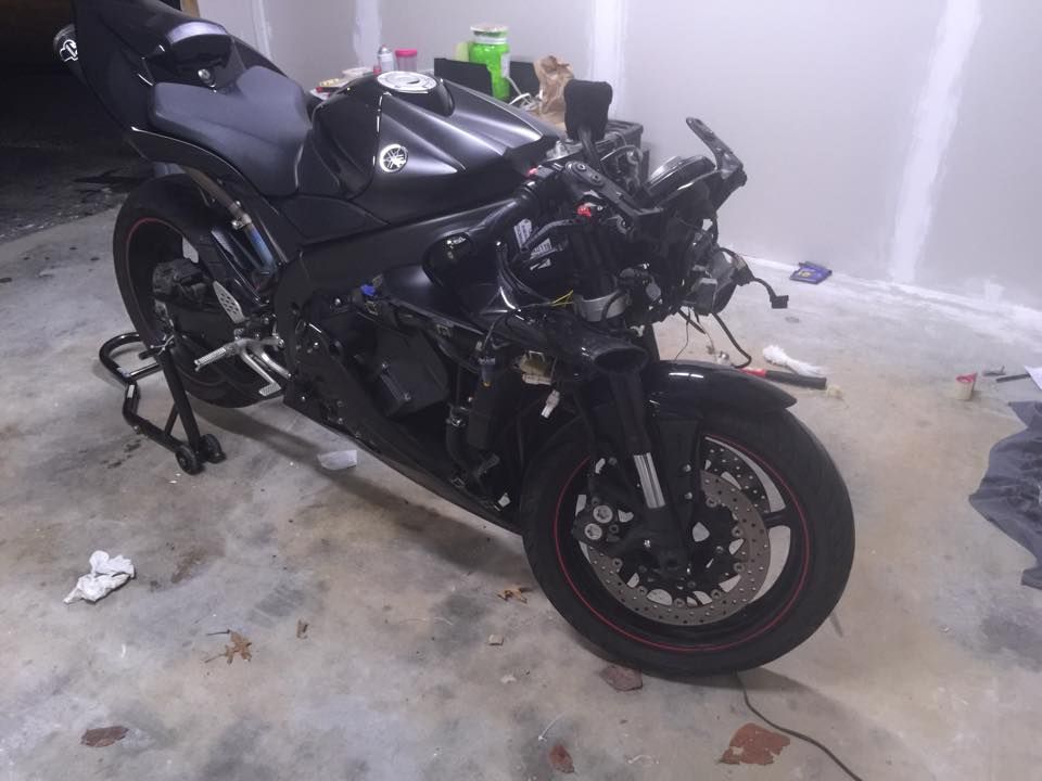

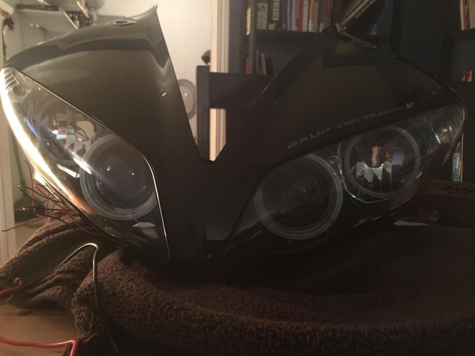

Well, I've had a little bit of extra time lately and the weather is cold so I pulled my fairings and installed my COB angel eyes. The worst part by far was removing the fairings. Like I said before, I HATE removing and installing fairings. Once I got past that it really didn't take me long to open the headlights and install the COB halos. I also made a little panel above my gauges for my toggle switches since I didn't want to cut my fairings. I'll try to get my fairings on tomorrow and get some pics. I tested the angel eyes throughout the process using my truck battery and everything works. I used the drill + wire twist method instead of glue. I've heard glue discolors, melts, causes fog in the headlight etc etc so I thought I would give wire twisting a try. The wires are ALMOST invisible, if you look close you may be able to see them. Here's a preview:

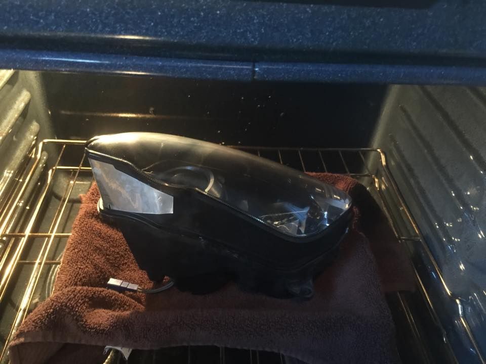

What temp/duration did you use to melt the adhesive and separate the headlamp assemblies? I'm doing a somewhat similar project and need to know the best way. I was thinking ~ 200 degrees for 10 minutes?
I did 250 degrees for 7 minutes and it worked perfectly. Be careful when you reseal the headlight though. My angel eyes have a clear coating over the actual light diodes and one looked like it got slightly warped from the heat "angel eyes were facing down". The second headlight I put in with the angel eyes facing up and didn't have that problem. Function wasn't damaged at all, but it could have been if I had left it in much longer.

All done. I won't ever do this again unless someone wants to pay me. It took so much longer than I expected. I'm not a professional but I'm not new to bike modding either. I'd say I put around 20 hours into this all said and done, plus about a mile of wiring. When people say a rat's nest of wires they aren't kidding.
Here's where I ended up mounting my switches.
