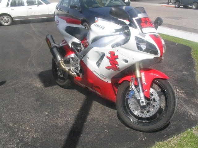

The insurance gave me most of what I was asking and I still had the bike, so I spent a few hundred making it ridable again, but ended up selling it a couple months later. Here's how it looked when I sold it
