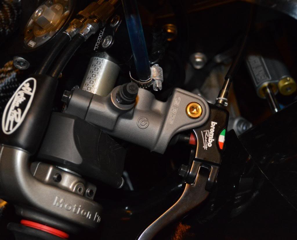

Update: We started hooking up our RCS with some nice accents. The first to go on is an gold titanium RCS lever bolt. It's an awesome looking piece, very much inspired by the MotoGP billet Brembo master cylinder.
After that, we opted for a CNC red handlebar clamp, like the one seen on GP style masters. I really like it. Between it, the gold lever bolt and the low drag lever, the RCS really has a nice MotoGP-inspired look.
Next installed will be a titanium banjo bolt for the RCS.
