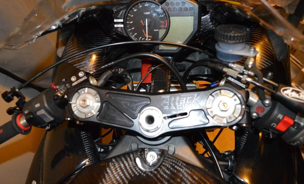

Some updates for you guys -
We updated the Spiegler lines front and rear to red with black fittings, to tie the theme together a bit. We also got some 90 degree valve stems, as suggested in the thread. They were attached to a set of Dymag CA5 carbon fiber wheels.
These things are awesome. Put them on the scale, they dropped right at 10lbs over the stockers. Amazing.
See less See more
I'm guessing those wheels arent gonna work in superstock. You changing classes? Also noticed your fork tubes are dropped way low into the upper triple. New geometry settings? I know Graves runs their bikes really tall. Says its the only way to get them to turn.
We'll be doing only Superbike and Formula 1 this season. Be nice to fit something else in there, but nothing else we can do. We run both ends pretty tall, the bike seems to respond well to it.
not quite to the point of using fork extenders yet?
They've talked about it, or more likely, extending the stroke a little bit, but for now they're OK. It doesn't need to be taller and everything is working well.
Man those wheels look amazing - the whole bike has really come together.
I'm running my forks flush like that and the rear height increased by ~16mm via one of the Sato links and the bike handles like a dream.
The more I see Renthal clip ons, the more I want them. Would I be able to attach Motovations bar end weights and sliders to them or would I have to modify them to fit? I see that they come with that little black nub.
wow guys the bike looks wicked !!
Thanks for the compliments guys! It's going to be a good season.
My forks are currently raise 10mm out of the triples and the rear is raised up 6mm via Graves shim. Once my SBU kit linkage and adjustable rod get here, I'll put them back flush.
