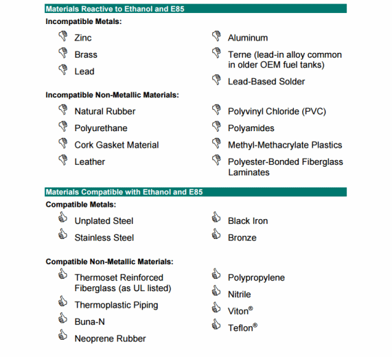

On a stock fuel system I wouldn't recommend it, you are correct, the rubber lines and incompatible materials will degrade and eventually fail. Without a tune, you will likely not gain any power NA, you can throw a lot of timing at it and maybe gain some power if NA, but you're going to need a good dyno tune with a PC3, or use a PC5 with autotune and a POD-300 for logging like i do. No need for dyno tune if you know what you're doing (I do).

What is needed to switch:
Compatible fuel pump, fuel lines made of of compatible material listed below, compatible fuel pressure regulator with return, larger injectors are favorable but I know a trick and am using my 2003 stock injectors (no its not upping the fuel pressure i run a base of 55psi), and most importantly a good tune.
