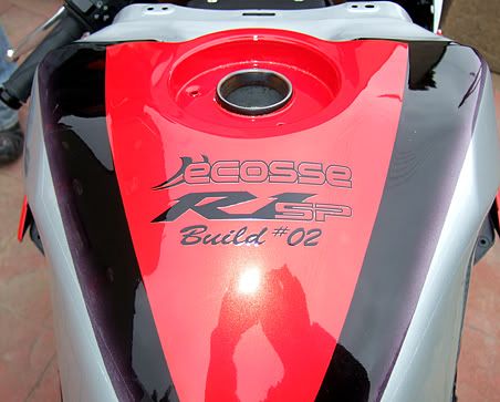

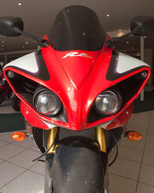

Thought i would post up some pics of my 2010 R1, that i have been building since last June. Bike was built by Ecosse Yamaha in Aberdeen - Scotland, hence the name. Ecosse R1 SP.
This is the 2nd R1 i have built in conjunction with Ecosse, the first being a 2007 bike, which was written off in 2008. When we decided to do another, i thought we will go better this time.
So, Ecosse took in 2 new Black R1's last May. 1 was for me, the other was to be their demonstrator bike. While we waited for the bikes to arrive, we went through a spec sheet of what we were going to build.

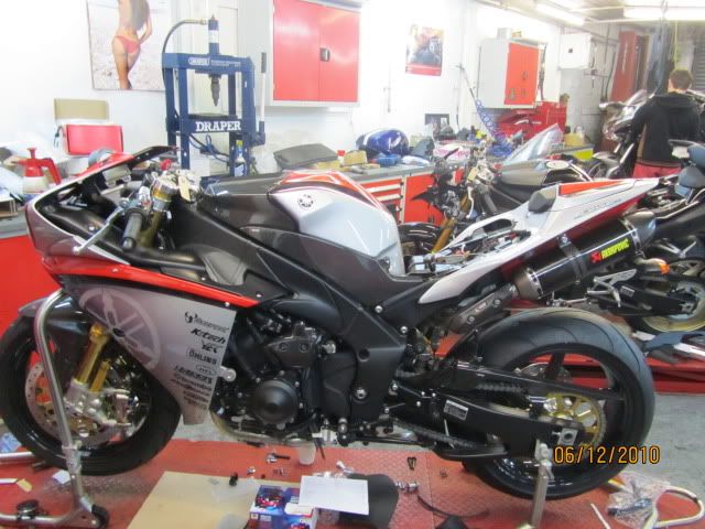

So we decided on engine tuning, top spec suspension, light wheels, and the obligatory paint job.

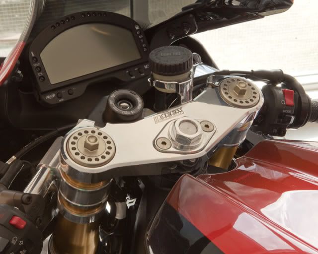

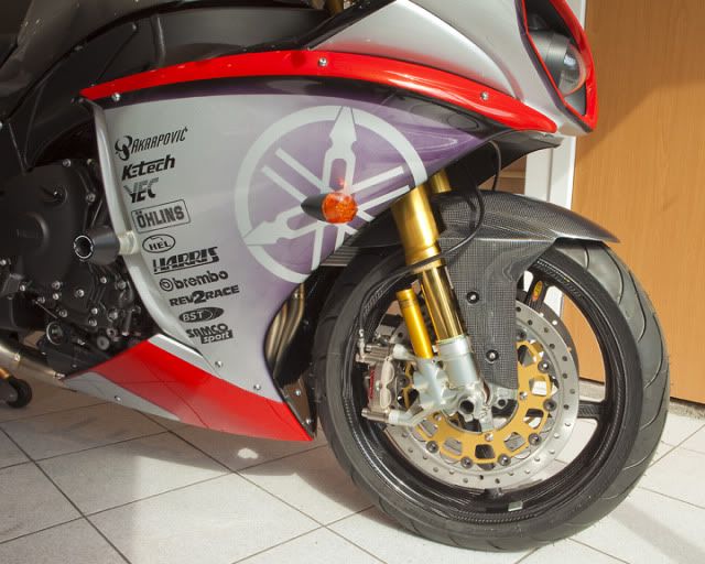

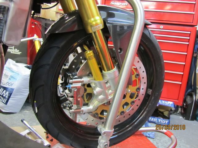

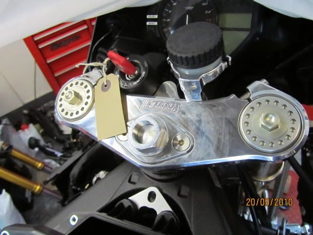

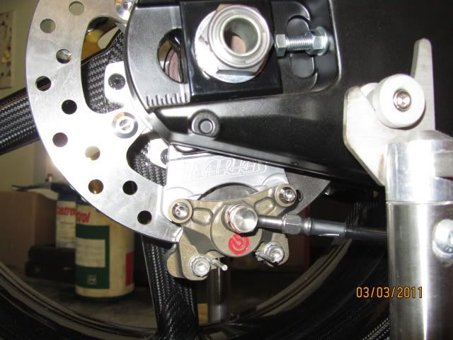

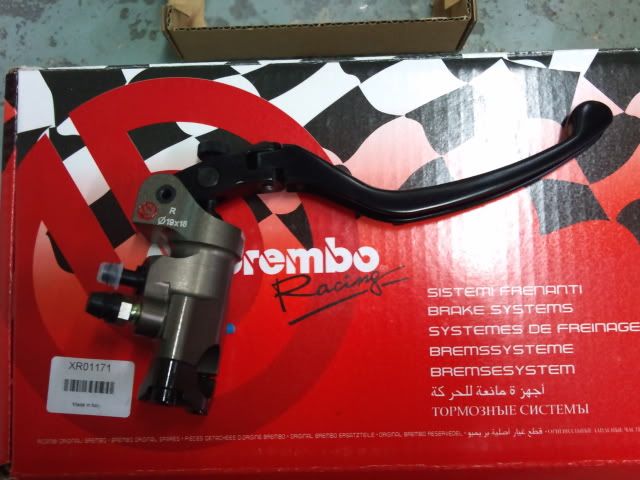

So, we spoke with Harris in the UK, and they said, if i was willing to wait a month, they could supply me with a set of 2010 Ohlins FGR-000 forks. So, we waited for them, a Ohlins TTX shock and damper. To fit the forks Harris built a custom Aluminium Yoke set, and also required custom wheel axle and C/F front fender. They also offered me a set of full on Brembo calipers and discs. This is the same set up as HM Plant Honda use in BSB, and they are the only team to get this set up. The master cylinder is a forged and machined Brembo WSB spec unit. The rear caliper is again, from Brembo's race parts and has quick release pads. We have mounted this underslung from a custom mount. To complete this, the bike is fitted with a set of BST carbon wheels. Couldn't believe how light these wheels were before we fitted the tyres.

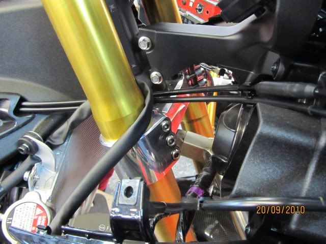

We had major issues fitting the steering damper, due to the size of the fork tubes, plus with it being a roadbike, it would hit the lights when at full lock. We had to make a custom bracket, and bolt it to the front subframe.

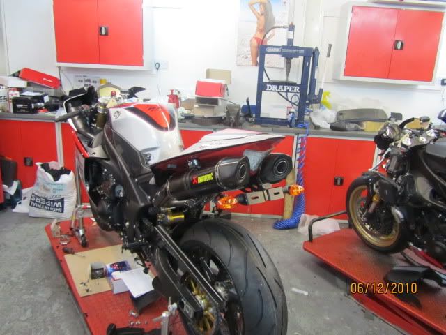

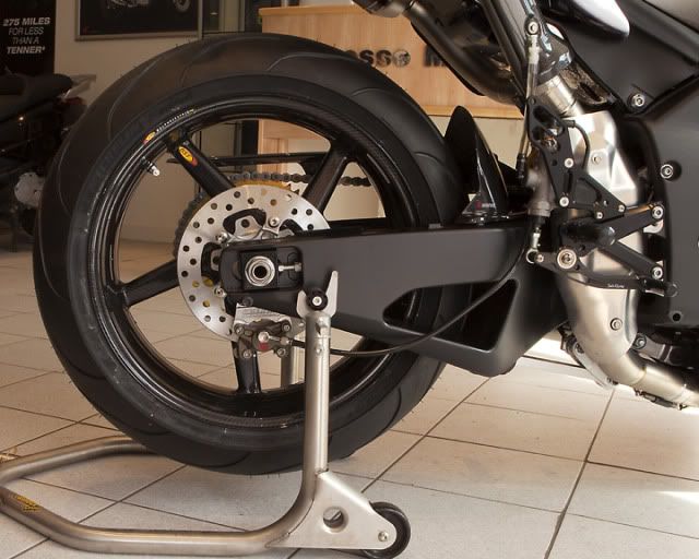

So, engine came back, now also fitted with a Sigma slipper Clutch and Samco hoses. Engine was re-fitted and a full Titanium Akrapovic stuck on.

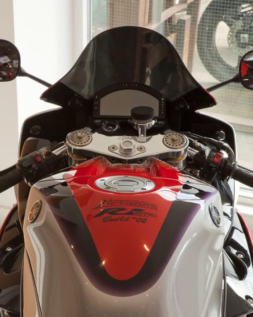

An AIM Dash has been fitted to the bike, but this has turned out to be nothing but hastle. We cannot get it to work properly, despite it being "plug and play". We refer to is as being more like plug and play about. Messed around for about 8 hours using a dyno to try to programme the gear indicator, to no avail. Cannot get the fuel light to read correctly. I have had very poor support from AIM with this, so it is about to be removed and sent back. I am going to replace it with a HM Dash, which i have been is plug and play, and if im not happy, they say i will get a full refund.

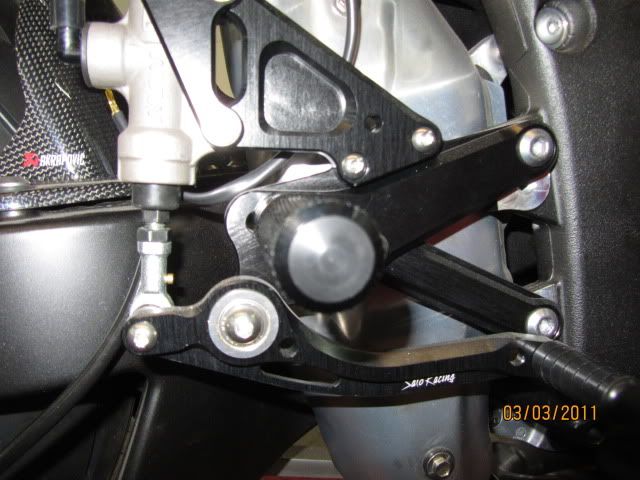

Other additions to the bike are Sato rearsets, Akrapovic Carbon parts. Probably a lot more i have forgotten. Quite a few Titanium fasteners are fitted, not for weight etc, but just to improve on the look of some of the standard parts.

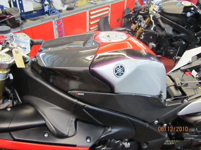

When the bike was built up, the front of the tank didn't look right, leaving the carbon front cover, bare carbon. So the tank was removed and the carbon painted. If you look at the pics, you can see the paint fades out from full paint, to near see through to show the bare carbon. This looks a lot better.
Also on the pics, it shows a K-Tech logo on the side panels. This has also been removed.
