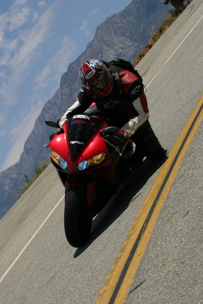

ok, so i decided i'm going to get a 35w xentec kit since i have them on my 02 with no problems and i'm a broke bastard lol. however, my 2013 is a completely different color scheme . i got a red and black scheme going on. so i'm torn between the 6000k which is white with a blue tint ( currently on my 02 that is blue and white), and i like them a lot. i'm also looking at the 5000k which are straight up white and i have never seen in person. i wish i had a better idea of what they would look like in the projectors. if anyone has pics of both temps in projectors, that would be awesome. also, i am totally welcoming opinions. i am attaching a pic of my bike to help with opinions. thanks guys!

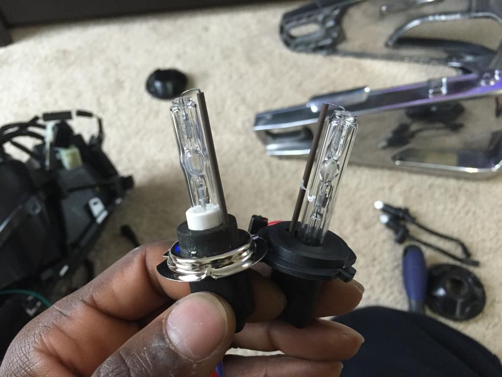

I'm just trying to help you all be safe. Heat resistance HID bulb bases and relay kits are safer for you and your bike.
The base of the bulb on the left that I posted earlier was made using Phillips parts. :fact
