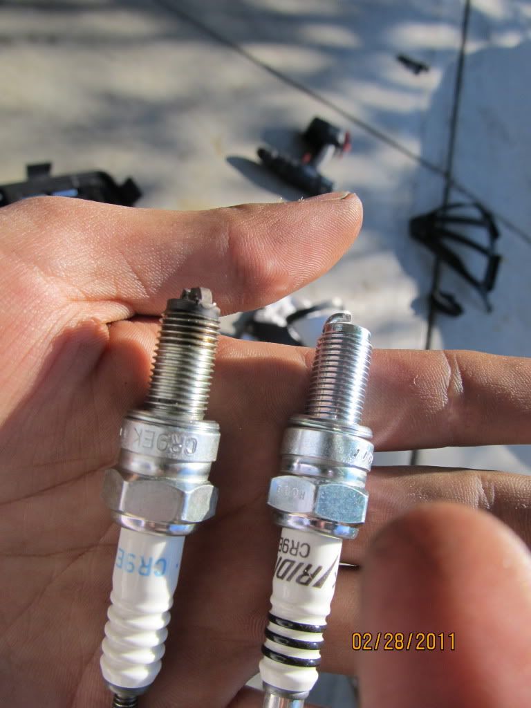

8) The stock part number is Ngk Cr9EK. I installed Ngk Iridium Cr9EIX
