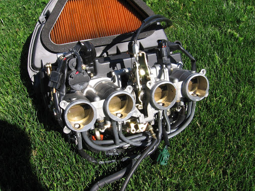

This is the best pic I could find, it's of the TB's looking up from underneath. The primary TPS sensor is on the upper right side between the two right throttle bodies (with the wires going into it), and the secondary sensor is on the upper left side between the two left throttle bodies, it's attached to that black plastic cylindrical thing which is the secondary throttle servo.
Remember this is a pic from below so the primary is on the left of the bike and secondary on the right.
