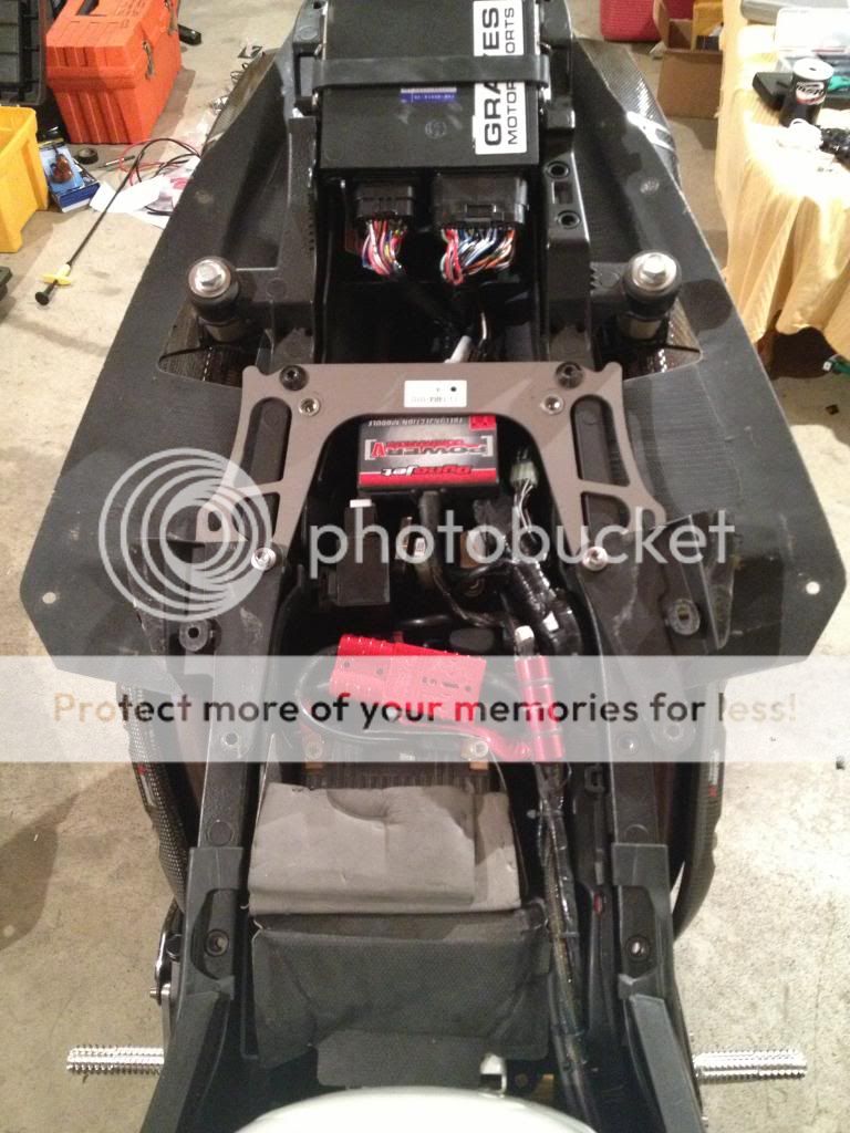

^^ What both of them said. Even though the lights go on and it turns over fine if the battery is slightly weak because of the cold it won't fine the plugs. I learned this the hard way at Barber in Nov 2012. We had our bikes out overnight in the paddock and the temps went into 30's with frost overnight. Next morning I went to start bike for tech and it wouldn't start. It turned over plenty fast or so I thought but it wouldn't start. Finally I took it down to Chuck Giachetto at Performance Cycleworks and he said to jump it off the car while the car was off only. It turned over very quickly then but Chuck said it was probably too late at that point and the plugs were already fouled. He said I could try to clean them or grt new plugs but recommended new plugs. he didnt have any in stock in his trailer. I spent all morning trying to get new plugs and changing them. A forum member had to drive 30 miles to a Yamaha dealer to get them so now I always carry a spare set of new plugs. Once changed it started right up. I have a Shorai Li battery in mine. Chuck said they work great until the temps drop below 40* then the starting amps drop dramatically. He wires a jumper pigtail to his race bikes so they can jump them with a fresh, warm battery if they ever needed to in a pinch. I have a quick disconnect on my battery now and just bring it in from the cold. By the time I got it running I missed all but the last two sessions of the day. It worked no problem on Sunday so at least I got most of my second day in. It was a hard lesson to learn after a 17 hr drive and one that won't happen again.
