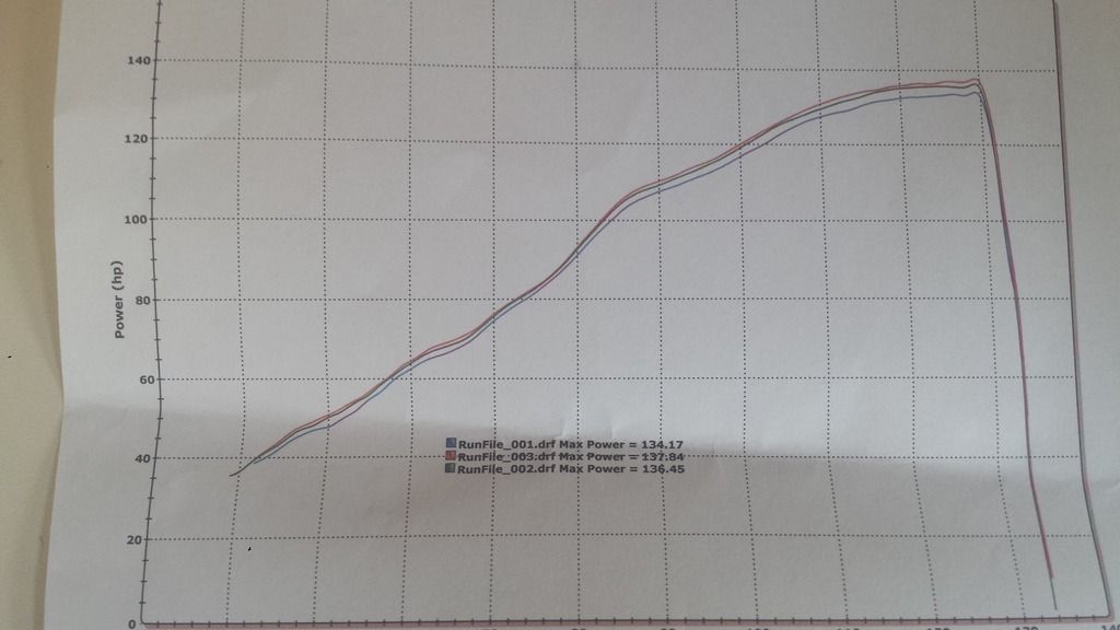

The FZ did pretty good considering I'm running the stock ECU. My mods are merely an Arrow header, 2 bros slip on, BMC air filter, stock air box, 2 bros Juice Box running Dukes Perfection Map that I have tweaked to allow the use of my o2 sensor.
The dyno temperature was read at 95° and 30% humidity.
The best run was 137.8 hp.

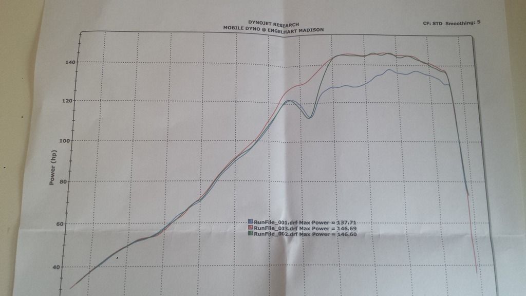

With it being free I had to see what my R1 would do as well. I knew I'd lose a few pounds of water weight but figured what the hell.
My R1 is pretty much bone stock other than the Yosh slip ons.
Its best run was 146.6 hp. Not alot of difference there between the 2 bikes. The butt dyno says different. The R1 feels a whole lot stronger than the numbers show. A member of the FZ1 forum pointed out the R1 has a steeper curve, which is consistent with the butt dyno.
I also didn't realize the the 3 runs were done in STD mode vs A Mode (Traction Control was off) so I'm not sure if that would have given me anymore...

my 09 dynoed at 158rwhp with just a 3/4 exhaust, flash n' tune with block-offs... dyno run was done on A d-mode
i seriously doubt STD mode would yield that much lower numbers and it certainly doesnt feel that way on the road,
both A mode an STD mode were upgraded/improved from stock with my ECUnleashed flash, B mode was left alone pretty much
with just slip-ons, no flash nor tune nor block-offs i believe it was pretty sad @ 148rwhp :nono:

hmm, im actually wondered about your numbers since you posted, and i've tried to test my baby on both STD and A mode hoping to feel a huge difference
in power output @ WOT, i really cannot say i have to be honest, its only in the early stages of acceleration where STD mode does lag behind A mode but
its really mostly just slightly less twitchy which makes it easy when in traffic. I wonder if they were utilizing some sort of correction factor on that dyno
as it being specifically a Harley shop, most old school blood prefer 'corrected values'... :dunno
