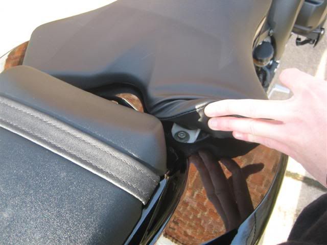

1. Remove seat by removing the two bolts

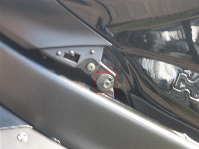

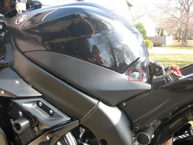

3. Remove the bolts from both sides of the tank.

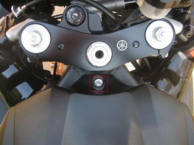

4. Remove the top bolt holding the tank down.

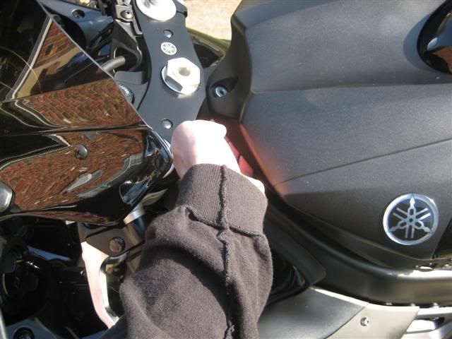

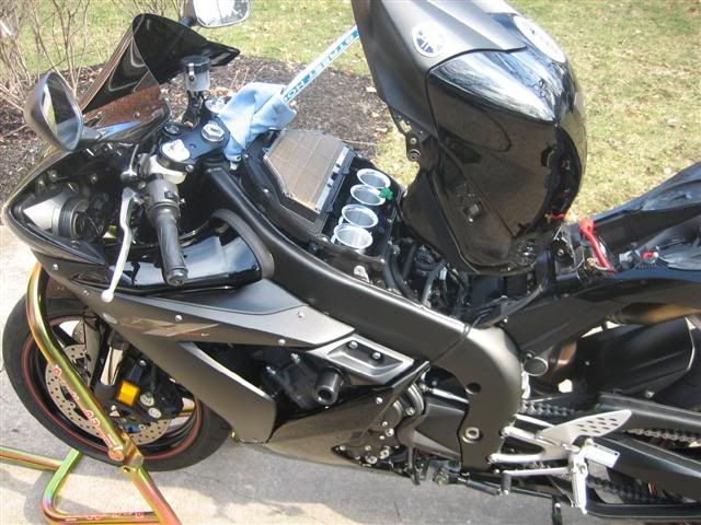

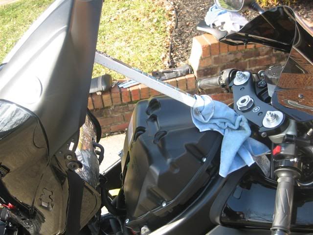

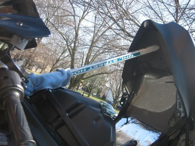

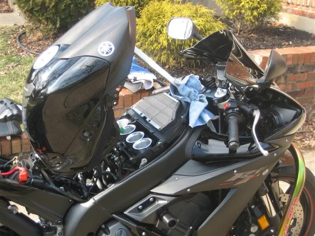

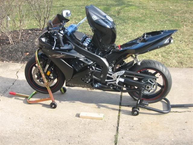

5. Lift and prop tank.

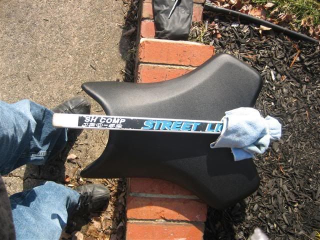

I cut down a hockey stick and wrapped one end to protect my triple tree, use whatever technique works best for you.

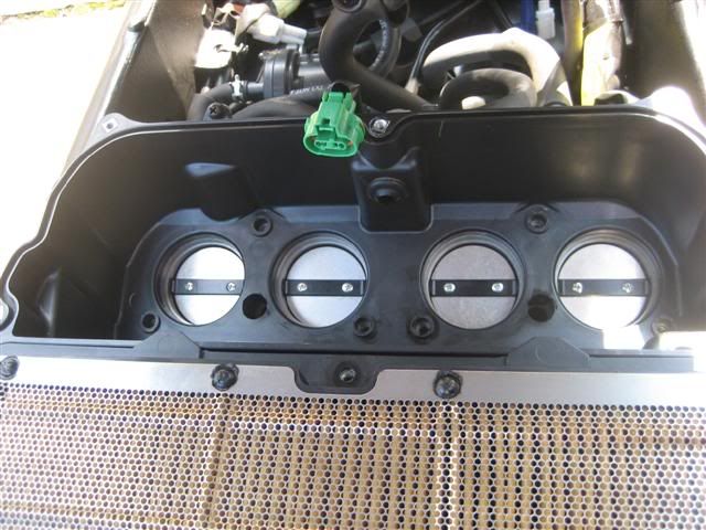

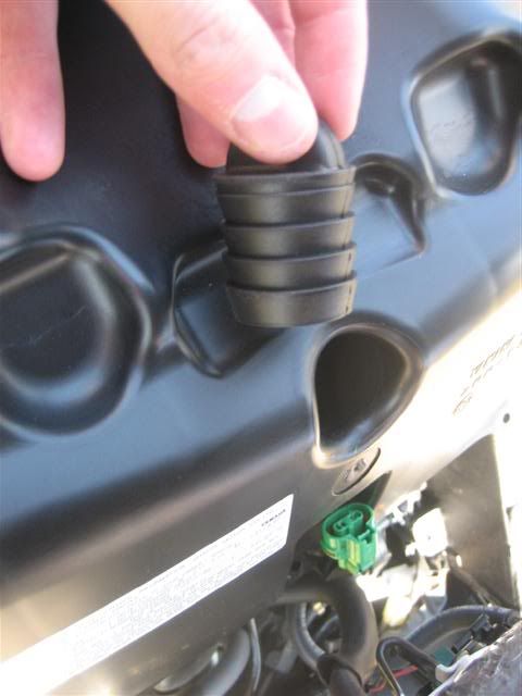

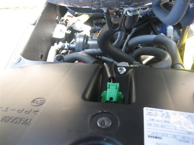

6. Remove the green connector and plug.

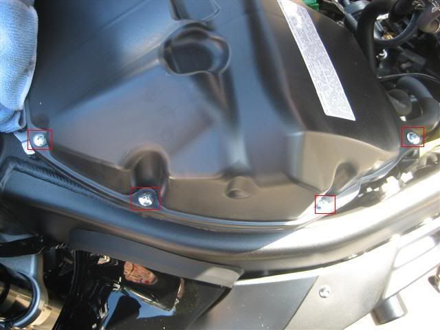

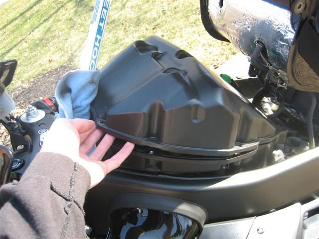

7. Remove all the screws holding down the cover, there is also a screw where you removed the plug, so don't forget about it.
8. Remove the cover.

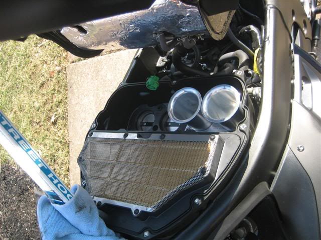

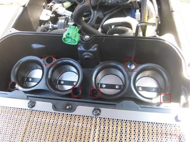

It should look something like this.
9. To remove the OEM stacks, remove the 6 bolts indicated.
When your done it should look something like this

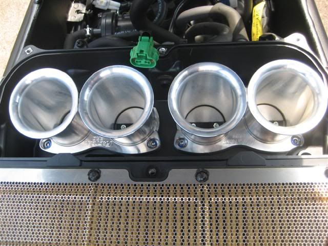

10. Install the new stacks: An easy way to install these would be by assembling the lower bracket and tubing first, then lowering the stack into place.
When they are all installed they should look like this

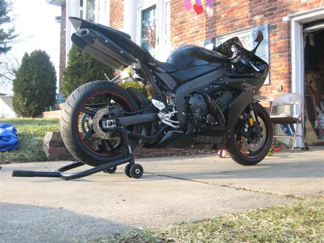

thanks.

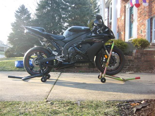

nice clean bike!
I clean it at least twice a week or every time before I ride, unfortunately I just lowsided two weeks ago, ground was cold, front tire slid about twleve fit and went down, sucks
