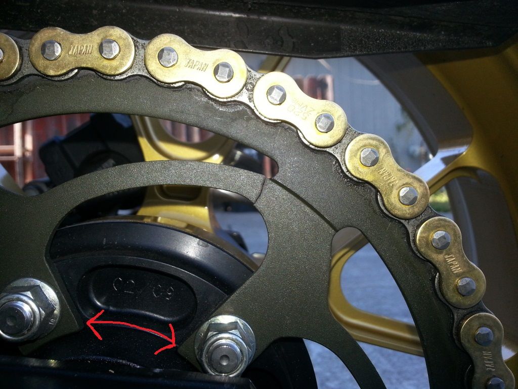

My R1 Destroyed The Drive Systems Superlite Rear Sprocket

no i do not do wheelies or stunt, this sprocket is 520 pitch stock oem 47 rear size, with less then 2000 miles, it has seen 2x track days

We have seen every design so far have issues. We are not willing to take the risk, but hopefully it holds up for you. Every other manufacturer stated what would happen and they were right, and they are saying the same things about the 3rd design, the one you have. Hopefully they are wrong though this time, but keep a very close eye on it.
Guys not all superlight steel sprockets are like this. We have had ZERO issues with Driven, Vortex, Stealth/Supersprox. We are dropping the Drive Systems brand due to issues with several different models. At least yours didn't do this as we had a few do this :( We had several other manufactures warn us of their product and we figured they were bias, until exactly what they said would happen, did happen. To people we know for a fact took care of their sprockets/chain kits. This is why DRiven, Vortex, Supersprox/Stealth won't take out as much material as Drive Systems does. They all state it's not strong enough and time has proven they were right.
Glad it didn't fail to the point you went down. I've said it before and I'll say it again, if you run these sprockets keep an eye on them...a close eye.
Think about it, in capatalism if someone has a great idea, unless it's patented everyone joins in...stainless brake lines, titanium exhausts, adjustable levers, lightweight chains, etc. superlight steel sprockets are awesome, but if making them this light was a good idea don't you think the big companies would do it? But they won't...Every other company that makes superlight steel sprockets will make them lightweight, but they all leave around the same material for a reason. It's 100% reliable. The last thing you want is a total failure of a rear sprocket. The teeth coming off due to a chain being too tight, used too long, etc is one thing, but it shouldn't just break apart at the locations that are designed to give the sprocket strength.

If you contact Brian over there and send the sprocket in he will replace it most likely, but you would have to ask him. That is what he was willing to for the customers of ours that had the issue. None of them wanted another one though and they all went with another brand, but if you like the sprocket I'm sure he will swap it out for you if you contact him.

look at this area where i drew on, there is no material connecting the sprocket together at all around the base of the bolts where it gets bolted to, that means all the stress points of failure are going to be extended completely out at the edge of the sprocket, this is horrible engineering.

wow... yeah thats a good point.. pretty badly thought out.. or not thought through enough to back it up with physics... weakest link scenario... :shake
