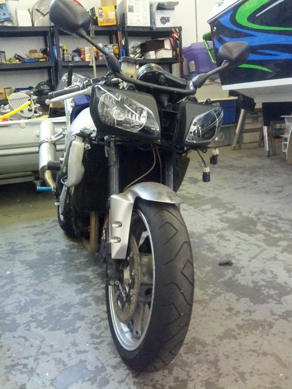

Here it is with new head lights

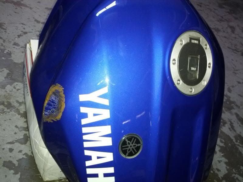

Shitty gas tank it came with

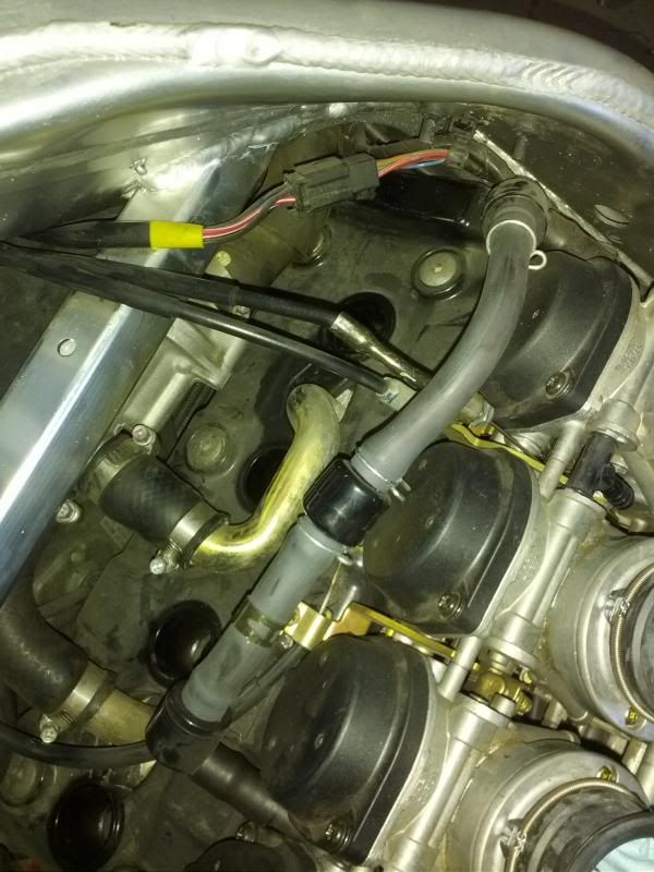

pulled the coils and cover

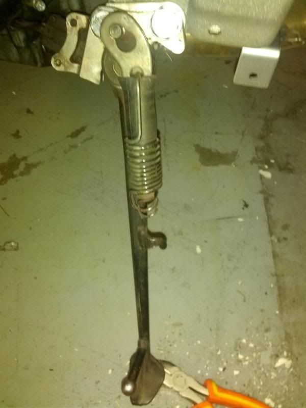

got a used kick stand as the bike didnt come with one. I had to use a stand every time I am not holding it up. Not that it really mattered as this bike had been down quite a few times.

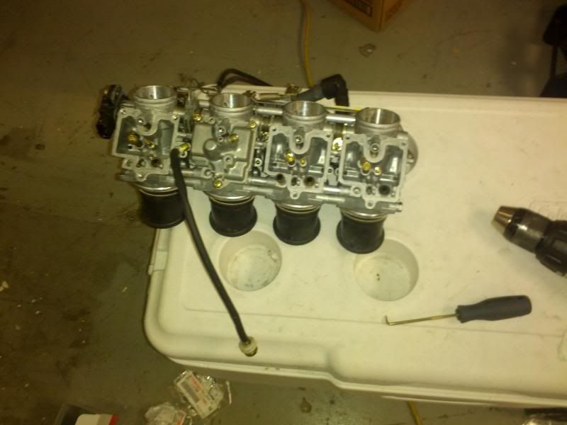

carbs being cleaned on my cooler/workbench
how it sits now
