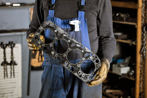

3) Water to oil leak
If the head gasket fails between an oil gallery and a water passage it will allow the engine oil and coolant to mix. This will result in contaminated oil (the white milky sludge or "milk shake" associated with a blown head gasket) and a compromise the cooling system.
7 different ways a head gasket can fail
4) Compression leak between cylinders
If the gasket fails across the fire rings it can allow the compression to leak from one cylinder to the next. This causes a loss of compression, and sometimes allows exhaust gasses back into the intake, depending on cam timing. This sort of head gasket leak typically results in rough running, misfires, and a loss of power.
