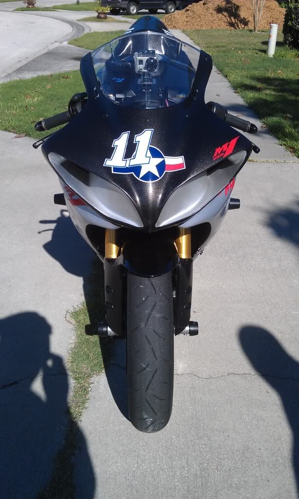

Last week I had just completed my track bodywork for my 09 R1 in time for the R1-Forum.com Memorial Track Weekend.
I didn't realize that I needed to mount and reconnect the air temperature sensor that mounts in the stock front fairing left inlet, until someone PM'd me about the part!
I had a Translogic MD3-12 Micro Dash installed before removing the OEM fairings so I never saw a fault code that would have shown on the stock dash.
I rode all weekend and didn't think I had a problem, but then I only had about 200 or so miles on the bike before bringing it to the track. So what happens if you leave this part disconnected?
