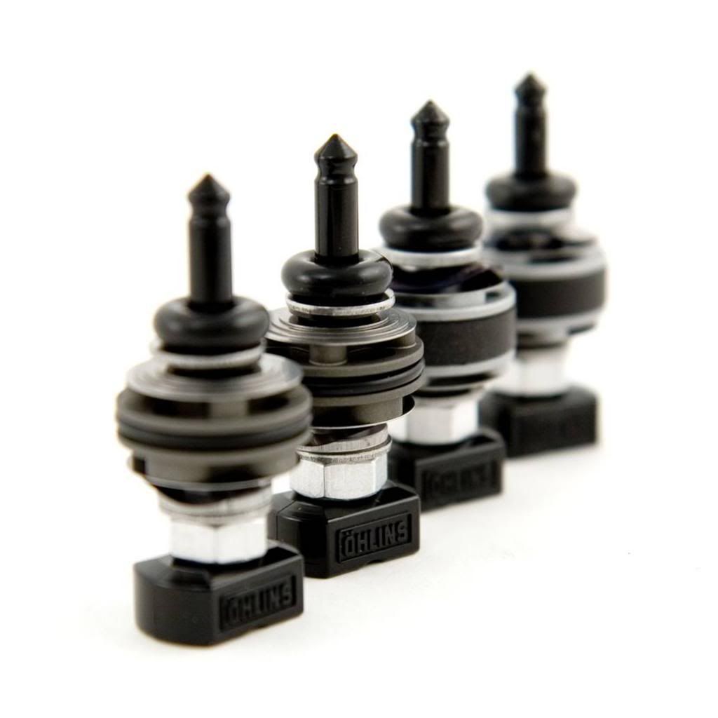

I did a ton of research on the Ohlins NIX 30mm cartridge kits... And from what I can retain, unless I'm going to be swapping springs often and/or need a wider range of adjustability, I don't "need" them. Honestly, I don't care if I'm 3 clicks out from maxing out comp/reb/etc settings; as long as I can get a decent setup at the end of the day :lol I figure I'll spaz out and eventually have a blinged out moment where I pick up some Black Edition Ohlins forks, but I'm not going to just ride dirty until that happens :dunno
OEM springs are 1.0kg, so I'm good there. Spoke with a tech over at West Coast GP Cycles about the install and requested any other suggestions (opportunities for them to make more money off me :lol) and he simply stated upgrading the 20mm valves in the OEM setup to Ohlins 30mm FPK and Ohlins fluid should be night and day for me (I asked about different springs, compression needles, etc.) and they charge $170+tax and there's a two-day turnaround... I'll be adding a shim to my shock while the bike is down so turn around time doesn't matter to me :dunno
Ohlins FPK $259.99
Ohlins Fork Oil $29.99
FPK Install by GP Cycles about $185
Total: $474.98 :rock: :boobies:

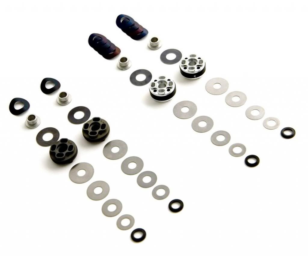

unfortunately, I have bad news... just finished up COMPRESSION SIDE
while we were busy having fun, and not paying the utmost attention,ahahha..
we were dropping the final spring and washers that make up the tail end of the Ohlins valve pack... and wouldnt you know it.!!
the Check Valve Shim, it was not centered properly with the rubber sleeve thats supposed to sit right on the bottom of the valve itself... :cryin
and of course we ended up cutting into it when we tried to bolt the whole thing in..
part number OHLINS CHECK VALVE SHIM 01115-26
of course there is another one of those on the REBOUND valve so
we just used that one to slap together the rest of it!!
it kinda blows but whatevs... right? COMPRESSION {LEFT FORK} IS done!!
DanQ to the rescue!! hahahah.. i guess i popped my SHIM CHERRY!! :shake
#41 · (Edited)
yeah it was bound to happen i guess... i got away with it this far, no issues...
funny thing is my buddy was bolting it on while i held the fork leg, "snap... silence"
ahemm... what was that i says.. oh thats just the spring settling in.. hahahhaha... :1pok:
hugh!??? you sure.? i dont know dude... ohhh fack... :dundun::shake
basically, the rubber/plastic spacer is supposed to sit in a little cutout on the center of the valve,
then the check valve shim around this... unfortunately we did not realize this, as there is very little
room to see whats what {1st time around didnt help either}. as we tightened the nut, the plastic
spacer pushed on the shim and bent it out of shape... we did check to make sure nothing was left
behind and I think we're good, but i'm so anal about stuff like this we'll probably open it up once more
when i do the other fork and make absolutely certain nothing is gonna bind in there... everything went
back in really easy.
