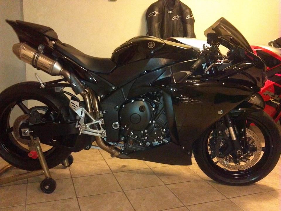

Here's what we had to work with initially, a clean street ridden machine (found here on R1-Forum), had about 2,000 miles and some Leo Vince exhaust. Even in stock form, it's an impressive machine to ride.
The first thing we did was ditch the OEM tires. We got some Bridgestone S20s, which were pretty nice for street tires, but didn't last very long. We then upgraded the brake lines to Spieglers, got some Carbone Lorraine XBK5 pads and Justin cut down the Leo Vince exhausts. He didn't do the prettiest job. They did sound cool though. We also began understanding how to flash the ECU and began our own tweaks on the ECU's engine braking and fueling settings. Right away the bike was considerably better with the tires and new brakes. The ECU flashing made the biggest improvement in rideability and performance. Much smoother and quicker. Here's a shot of the hacked cans:1pok: Don't worry. It gets better.
